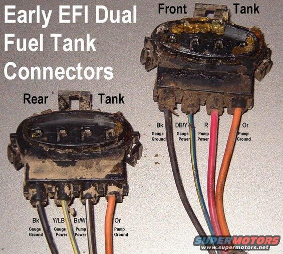

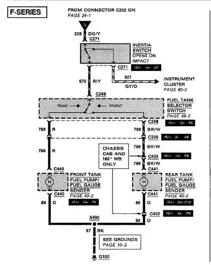

can anyone give me the colors for the rear tanks wiring harness as far as power and ground etc. I'm trying to chase down a wiring issue for the rear tank and trying to make sure I have power to the plug.
