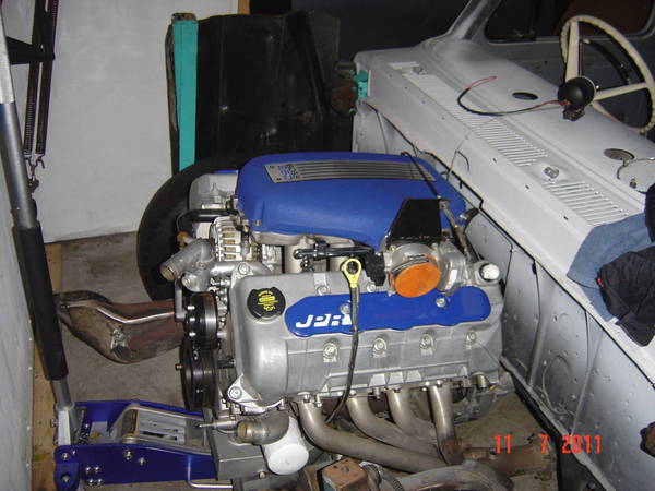

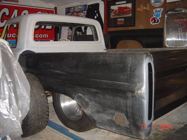

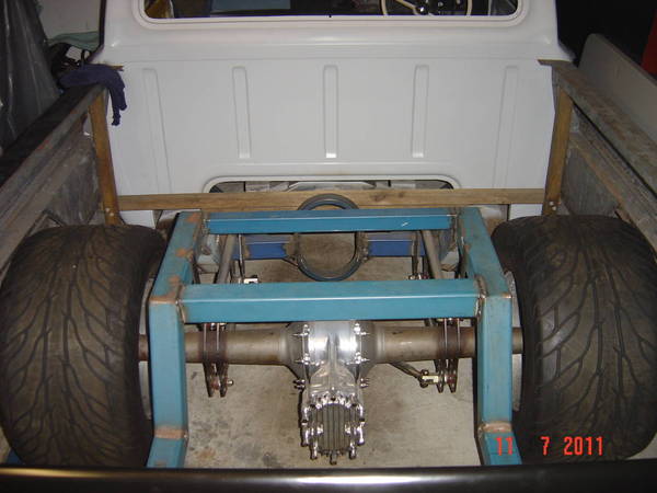

Hello all,this is my first post. I am Keith from Australia and i am building a 1969 short bed. My 69 has a few modifications ,took the roof off and lowered it and a peak was put in over front windscreen, pulled the b pillars in to fit flush with the doors.Tops of the doors were rounded. Removed fuel tank and filler hole. Pickup now sits on a custom chassis with independent front end and four link rear with coil overs.Body was channeled a bit over chassis so ground clearance in about 140mm.Rear is tubbed with 15-12 centerline auto drags and mickey thompson 29-15 sr street radials.Fronts 15-8.5 centerlines with mt 27-10 tyres. Engine is 5.4 quad cam all alloy ex gt production car race engine with motec m 800 ecu and 6spd tremec.Front brakes are four piston with two piston rear brakes.
