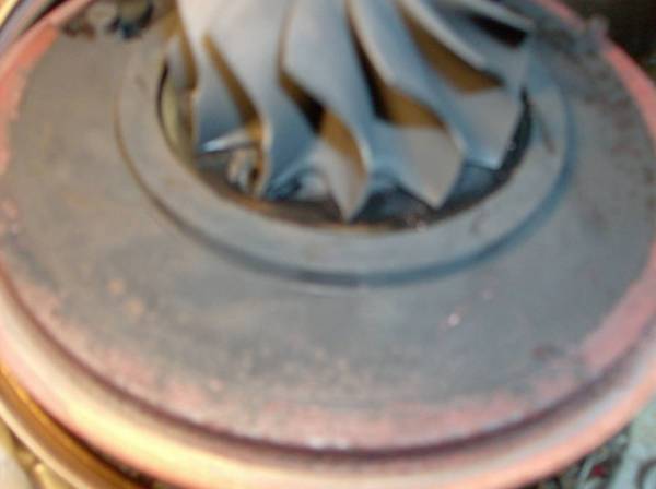

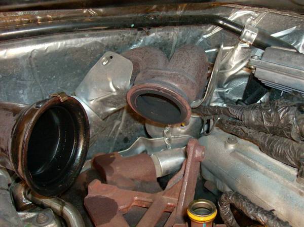

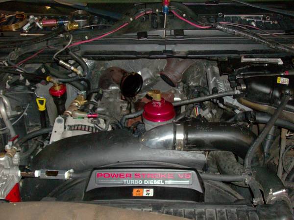

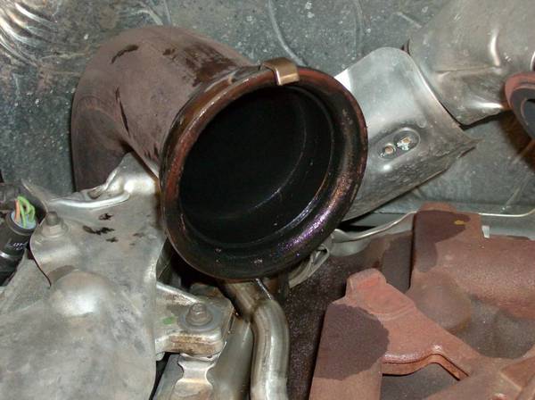

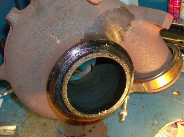

Trucks here, turbo's off, blew the seal inside the turbo. No oil in the turbo inlet pipe just the outlet, truck runs like a animal, not finding any excessive blow-by or coolant in the oil, I think what your seeing is condensation in the CCV hose with the normal crankcase pressures, you have to remember normaly this gets sucked back into the engine and burned, now you have a hose on it your going to see some oil dripping out of it, as well as condensation with these colder temps were having. Heres some pics.
kind of hard to see the oil coming out from under the impeller.

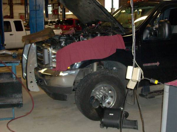

I see engine compartment with the tubro out, I say how they get it out so quick, I think I'd hurt my self tring to do it. Glad the CCV hose thing is not part of the failure. Also that it is a seal on the turbo for the oil leak.

I can have the turbo out in less than an hour it's pretty easy when you do it all the time... Crankcase pressure seems normal to me no extra huffing thing runs great. I'll call you with the even better news.!!
