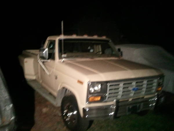

my new toy 85 f350 XL 2wd 4speed 176k
72
1
Well didn't get much time to tinker.fuel leak all over trans x member area. Dead batteries. Still retaining factory water seperator. I also think I will have to address the glow plug system..get some battery pwr 1st then see if I have fuel and check plugs..
Worst spots on the cab are the cab corners. It needs a good cleaning. Not too bad for 25+ years. Second owner only put 6000 miles on it.
That's it for now I guess.

is this the new toy
keep us updated on the progress
whoa, pretty clean lookin'
watch out for Huntavirus from those mice!
on the plus side 6.9's run forever...

is this the new toy
Yup! Thanks for the pic. For some reason I had trouble posting it from the phone.
Thanks for the heads up on the virus. I will be wearing a respirator next adventure in.
The picture hides a lot. In its lifetime the bed has been replaced andthe truck was painted.it used to be two tone, the color you see and a brown.
For the most part the paint is still good and will clean up but the cab corners and part of the rockers are gone including the floor where the seatbelt mounts. Also some rot on the drain rail. I will be able to use this until I find a new home for the drivetrain.
