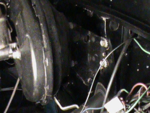

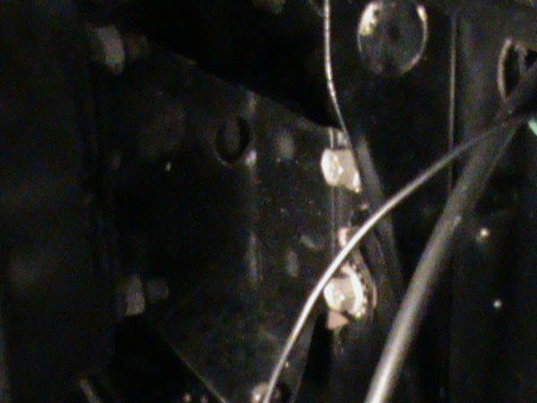

If i remember correctly G.O. when i did my 76 bumble bee...I used the kickout bracket from the fire wall to the back of the booster and the Piston rod..I aquired mine from a doner truck that my neighbor and i went in on and i believe it was a 79 1/2 ton 4x4.Now its been some time ago so details are kind of sketchy mind you but im pretty sure it all bolted up..I do know it didnt take a great deal of time to do and no unforseen issues...It made a Huge difference...first time i hit that pedal i about went through the windshiled..seriously!
This is a pic of my 79's setup..keep in mind tho it is an F-250! it may give you an idea of the setup
Thanks for the pics. I found a guy selling the bracket on Craigslist. Got it home today and bolted on my new master/booster combo. Then bolted that to the firewall and hooked everything back up. I bench bled the booster and then bled the brakes. Took it for a drive and WOW. Not only do they work now, but talk about some stopping power haha. Much better. Working great. The brake light switch didn't touch anymore so I took a screw and put it into the end of the switch and now it's working fine. Honestly, it was a pretty cheap upgrade that both fixed and bettered the brakes.
