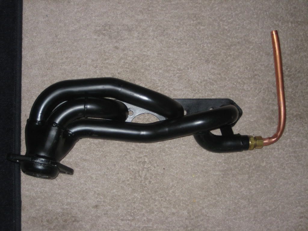

It was a pretty seamless job. I only had one hitch. The EGR tube on the stock manifold wouldn't fit with the new headers. The headers placed the tube forward of it's stock position, so I had to fab a new tube.

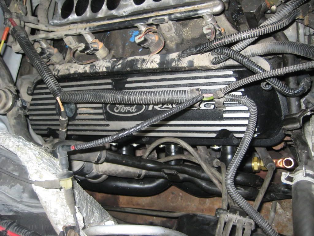

it looks like that was a lot of fun! I like the valve covers, they look good. A black/silver upper intake to match would look cool.

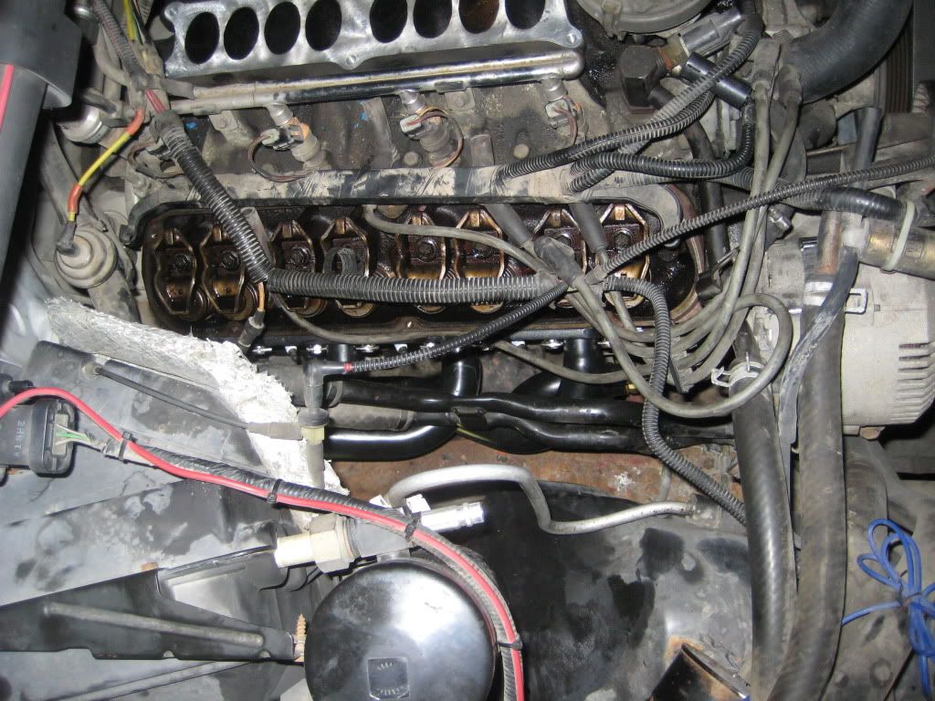

A question that may help me with a project... in your 2nd picture down, it looks like 2 heater hoses in the lower right of the picture. The heater hose on the right appears to connect to a metal pipe of some type. How does this pipe connect to the water pump?
I don't believe those are the heater hoses. I'm not sure what they do, I just moved them out of the way. My heater hoses run up closer to the passenger side fender and go through the firewall up near the top corner.

Those lines are coolant lines for the intake plenum. Helps vaporize the fuel from the injectors too.
