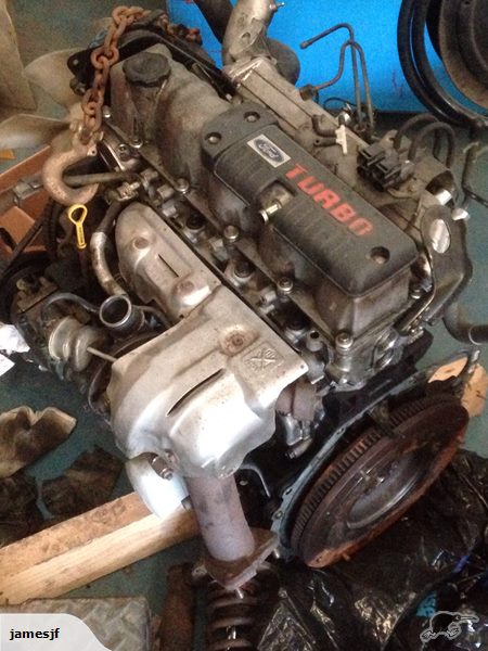

I should send you one of these for it Roger - these are good little engines that just go and go and go forever , 2.5 turbo diesel. they have a 3.5 ton towing limit on them here and sad to say they'll out tow my F150 up hill.
