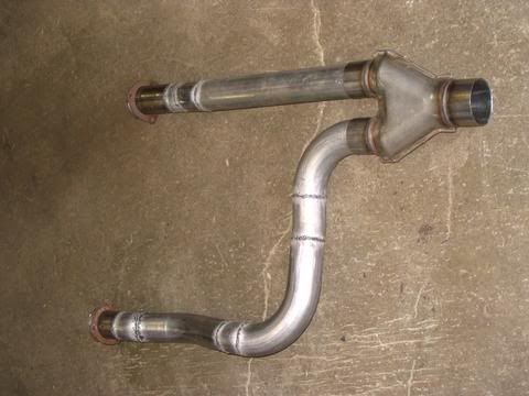

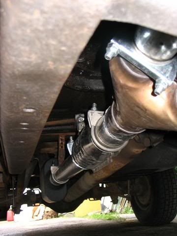

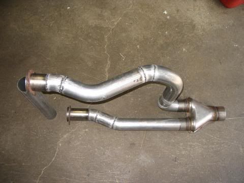

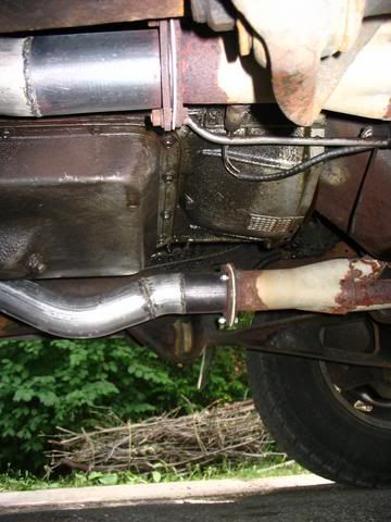

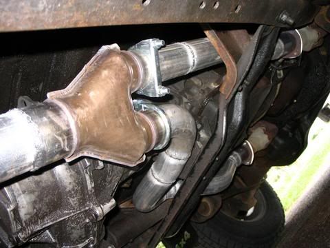

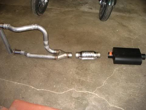

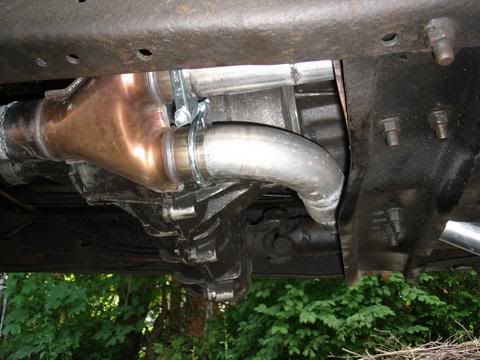

Conanski (Paul) has about the best custom setup that I've seen:
And he did it all with pre-bent pieces of mandrel bent tubing-- he didn't have to bend anything.

I never had luck with tubing hitting off (Lousie PA roads u know) crossmember when routing it that way .But is really a nice clean job .
