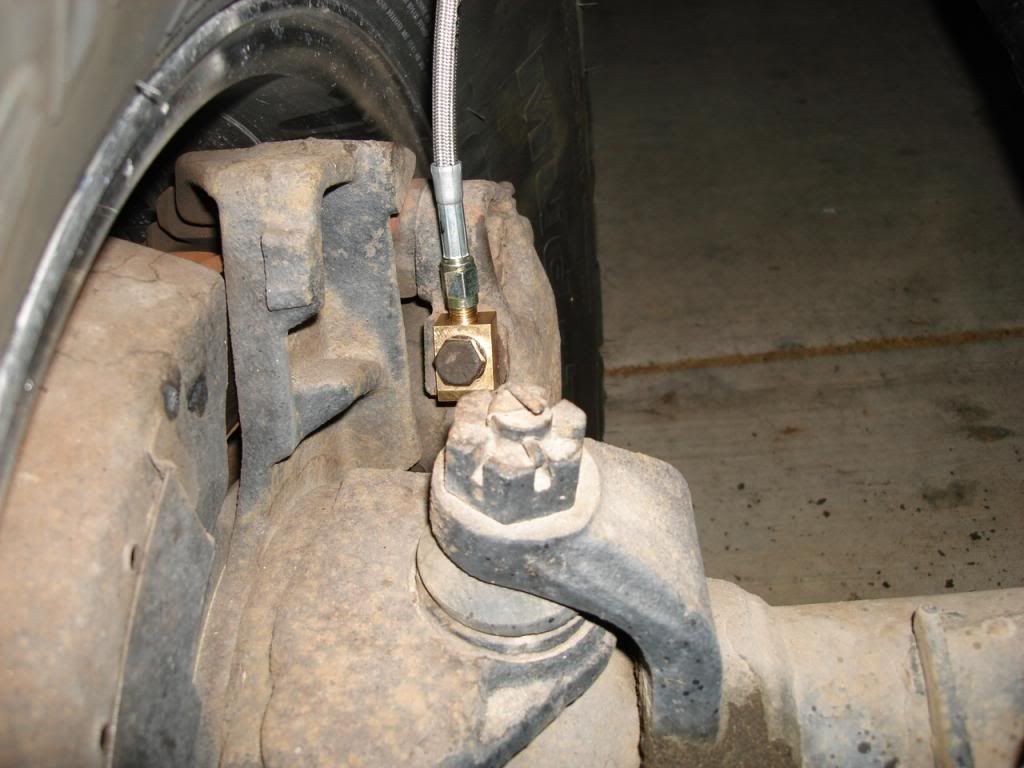

Hello all,
I thought i would share info on a product. It might save someone some time and money in the future.
I bought the extended brake lines from skyjacker and they are junk in my opinion. They use a generic hose cut to length and then have adapters to fit any truck. I think that is poor at best plus the brake line now rubs the tire and their solution is a zip tie. They actually send zip ties with the lines. They could have at the least used a banjo with a angled fitting.

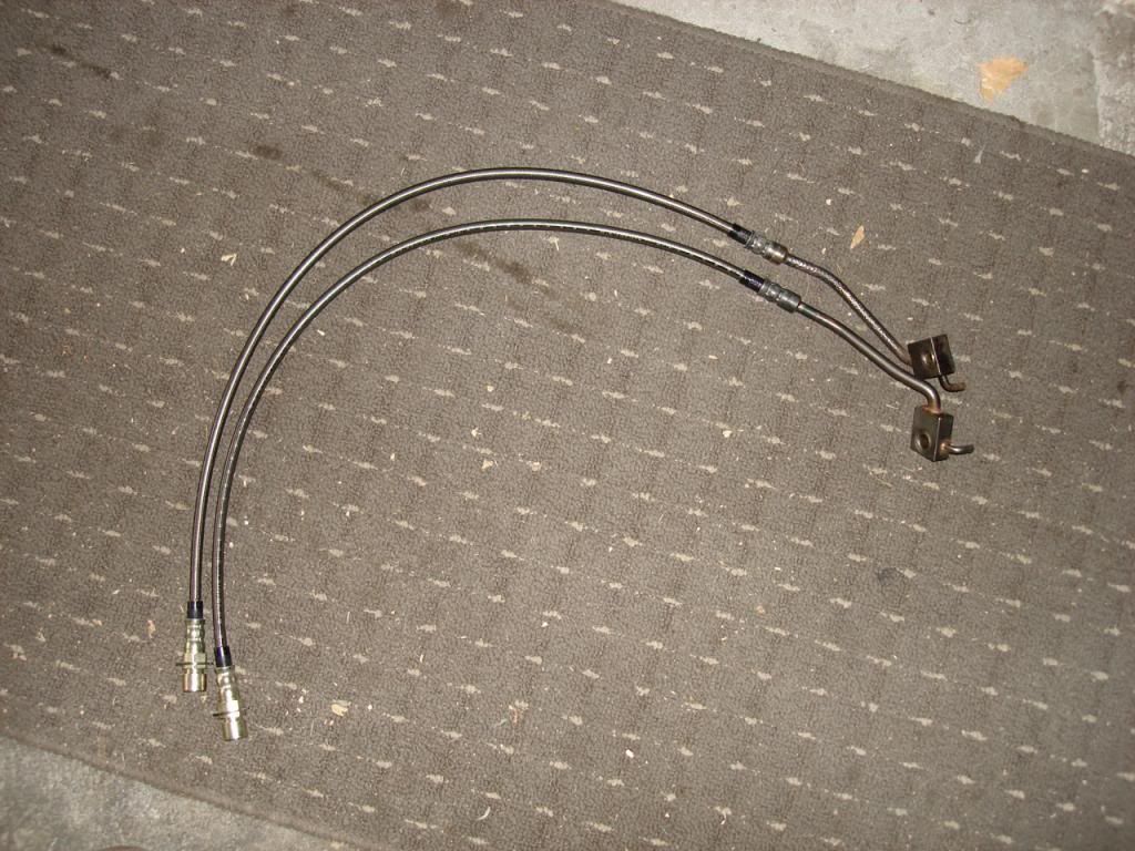

I took my old lines to a local shop ( All Hose) and they used my old banjo, installed new braided line and the correct fitting. All of this cost less than the skyjacker lines.
Here are a few pics. I hope this helps someone from wasting 100$.
Skyjacker junk
made from All Hose
