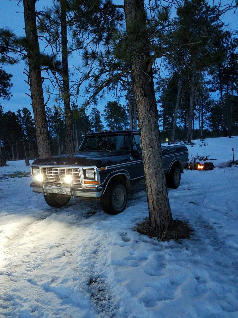

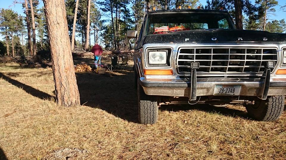

I just went with rigid driving lights. They are not street legal, but in my area, that is not too much of an issue. I have a separate switch for on/off. They compliment the Hella headlights quite well.
I have been stopped once and told they were not street legal. I told the officer that I had a hard time seeing at night, and he just told me to be a little more discreet about it.
