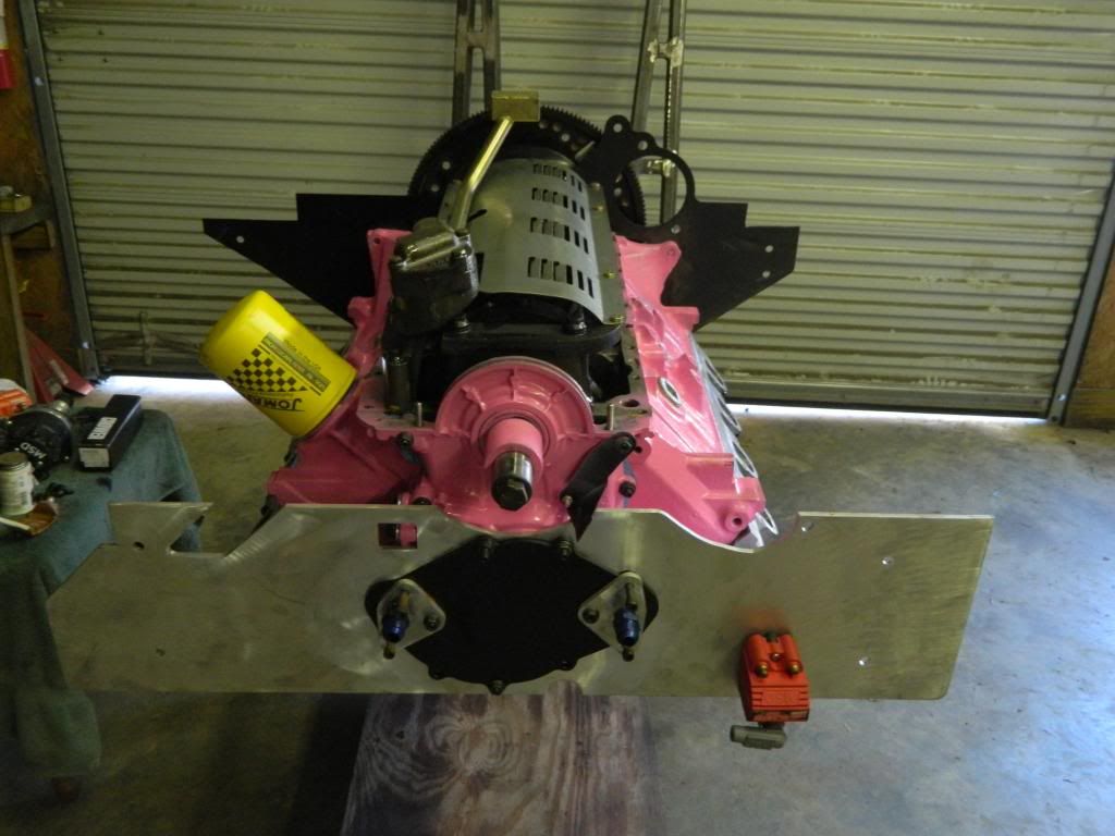

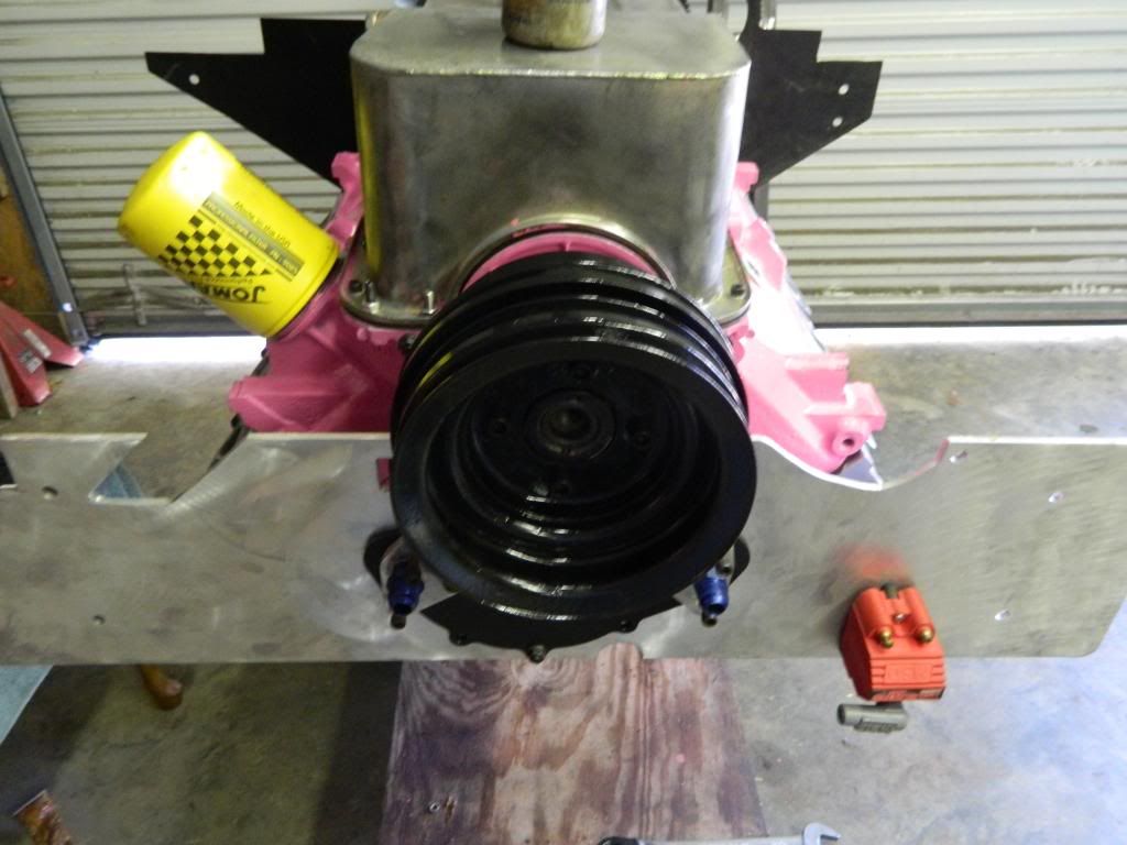

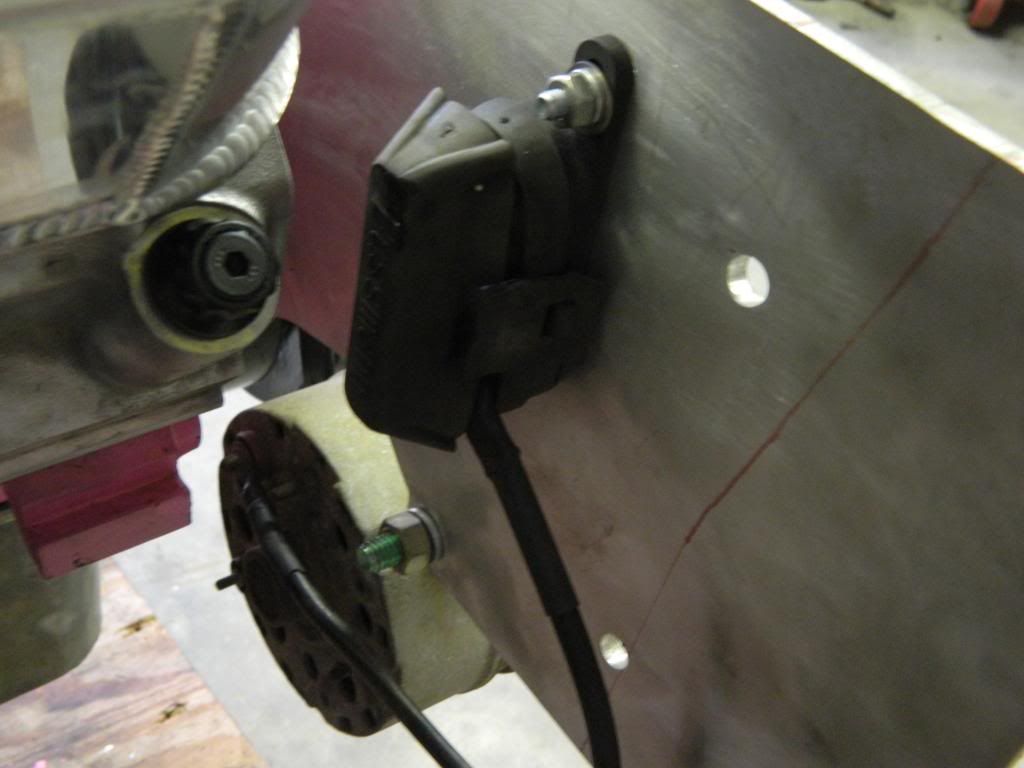

Pickup bolted on

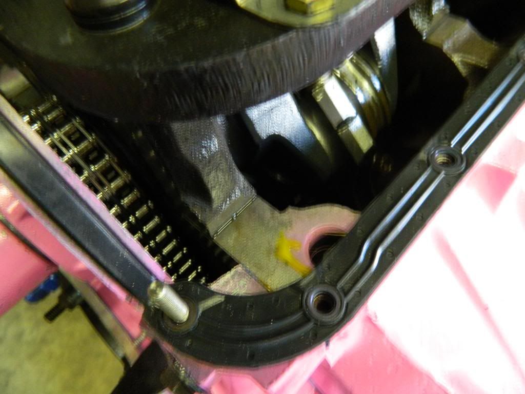

FRPP 1 piece oil pan gasket

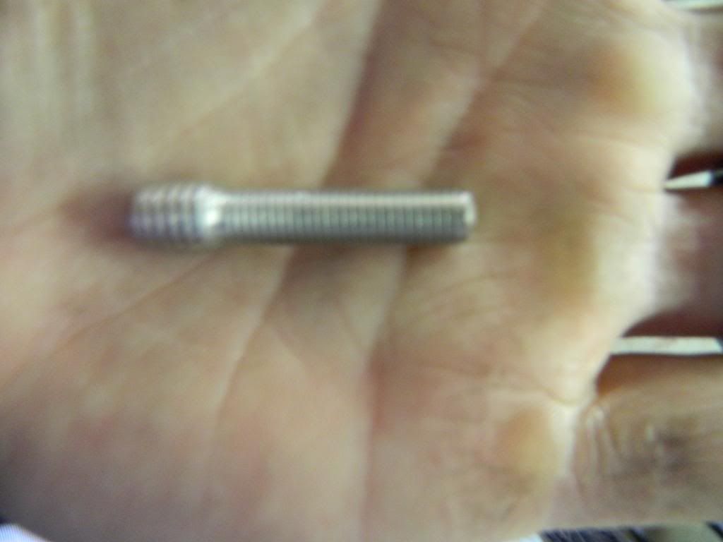

The problem with the 1pc gaskets with the steel core is that all the holes are 1/4 and its really difficult to enlarge the 4- 5/16" bolt holes without screwing up the gasket.
LEBs solution 5/16x1/4 stainless studs
Fits real nice
Canton 7qt pan with internal baffles

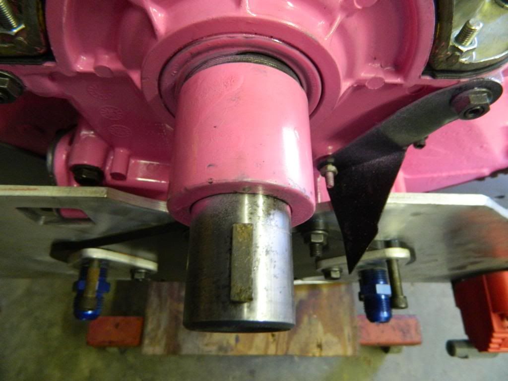

Tap the little half moon key in and smoke a cigar while you make balancer soup

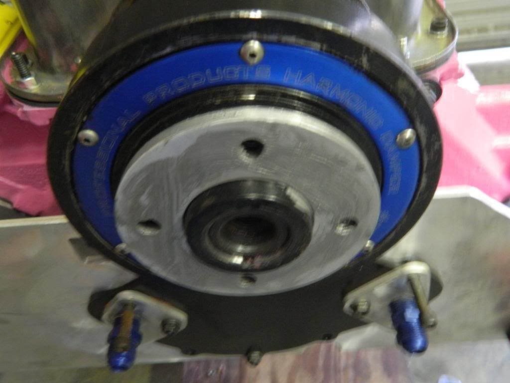

Slide it on.
Slather some anti-seize on both sides of the spacer and slap it on
Bolt on the pulley

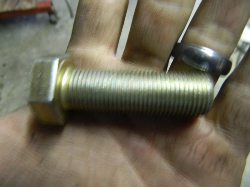

New crank bolt - 5/8x2 fine thread grade 8

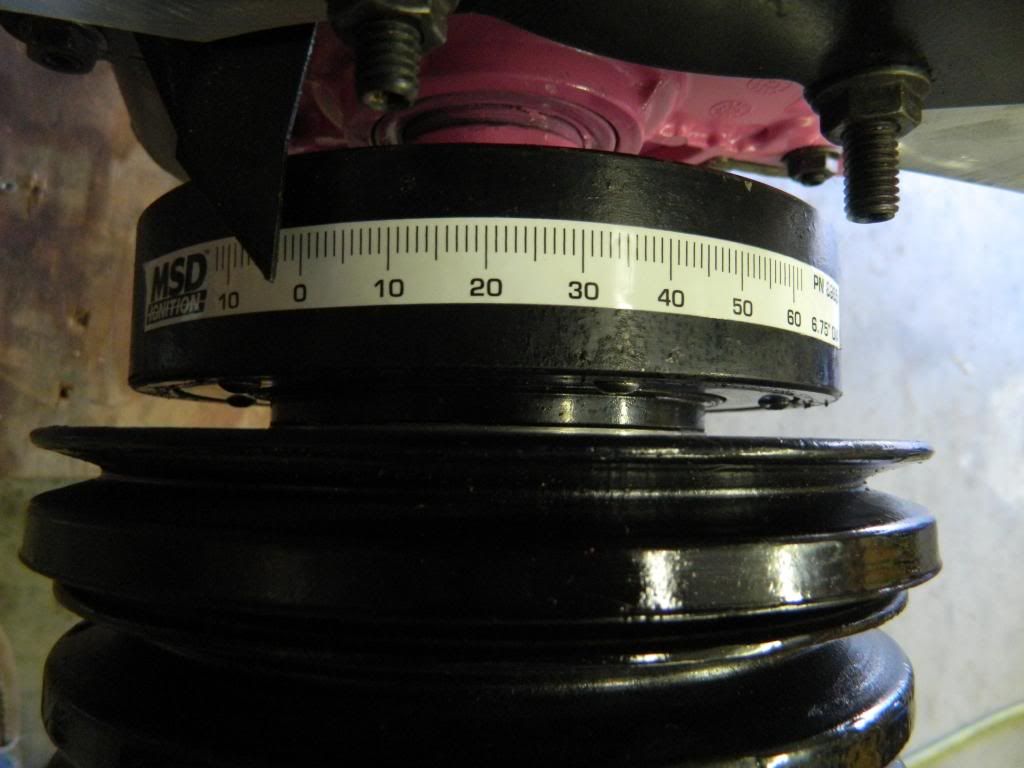

MSD timing tape

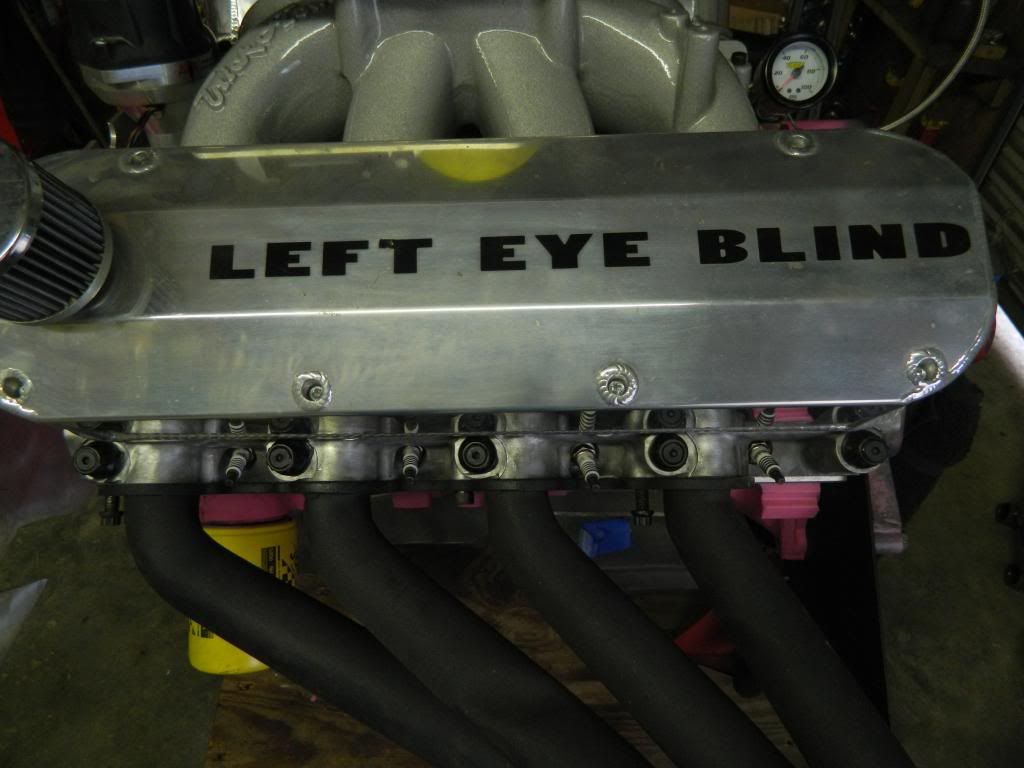

Respect the valve covers!

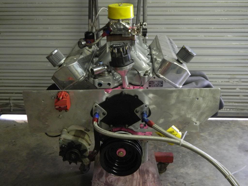

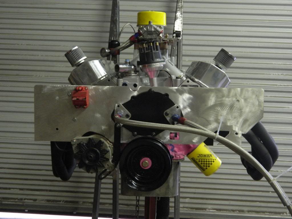

All done - The headers are 2" primary 3.5" collector Mad dogs with Jethot 2000* crinkle black coating.
3g alternator fuse block. The mock up alternator is not 3g.

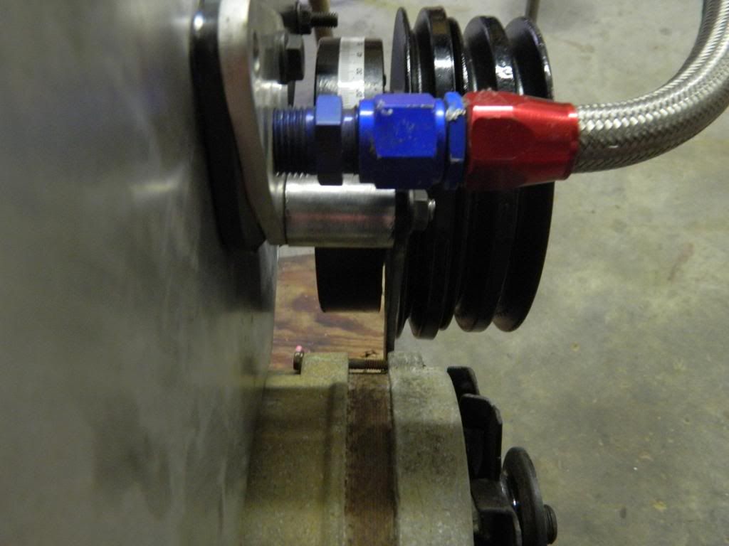

Spacer required to make it all line up
Coil
