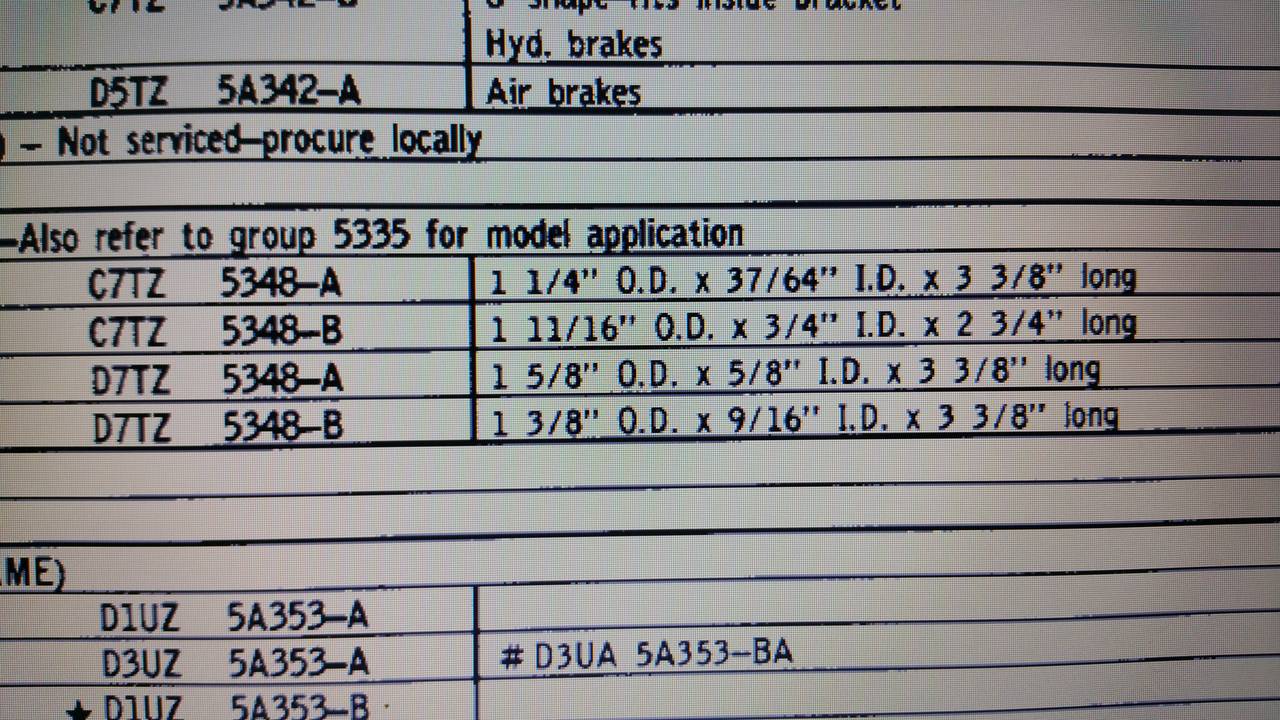

No sweat...I will have a look in my parts book tomorrow and see if I can find a number that could be crossed to something.
I didn't get a chance to look today...I will for sure tomorow.
This is all I could come up with:

I received the bushings from rock auto yesterday,

correct part
I pressed in a new bushing and it is correct.
I used a McQuay-Norris SK6530. Perfect fit.
