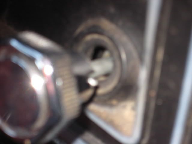

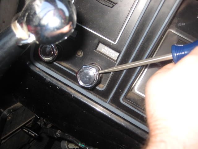

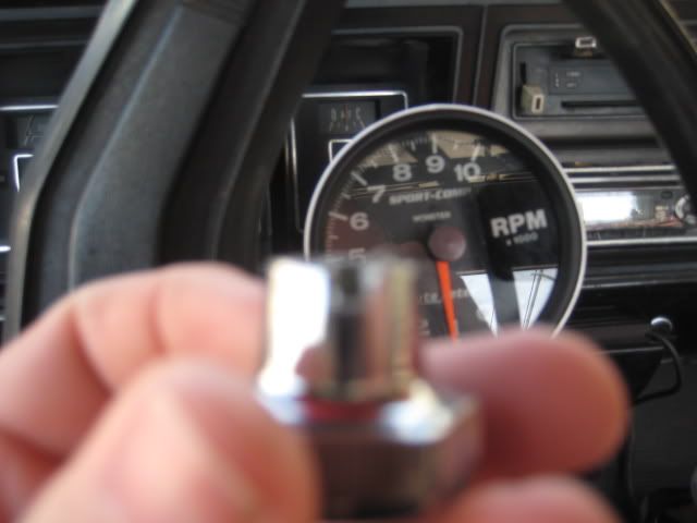

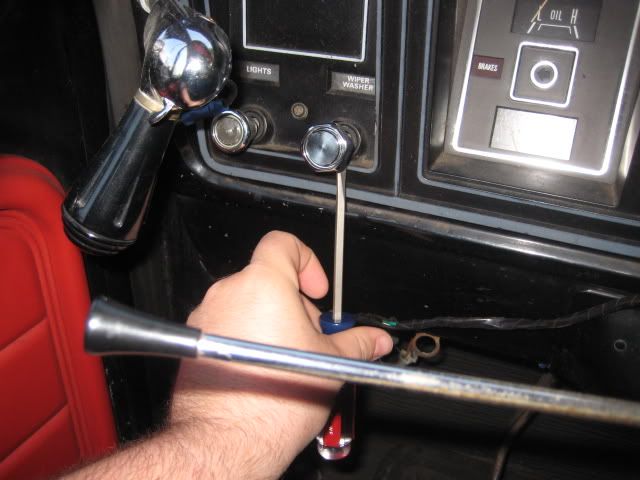

No it is on the knob itself. Lemme go see if I can get a picture real quick
Ok here are a few pics. If you have delay wipers you can turn knob to delay and the cut out should be to side by steering wheel or down in the off position on delay or non-delay wipers. At least that is how it is on my 73.
Hope this helps. Video was too hard to make. Couldn't remove knob while holding camera.
