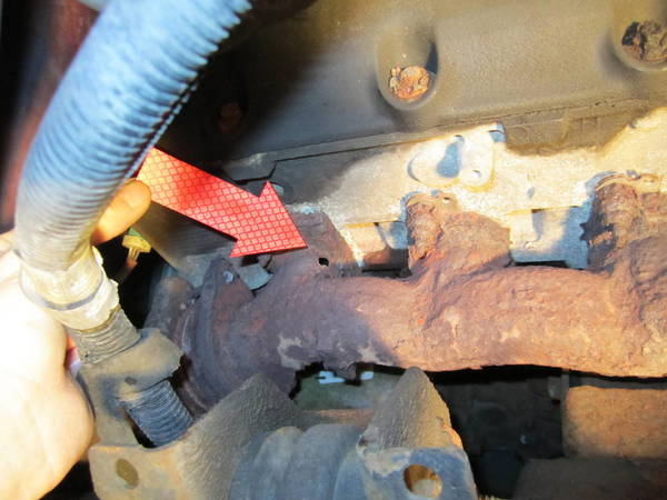

Finally got the time too tear into her. Once I got the plastic inner fender removed you could see the crack in the manifold. (Pictured is after I enlarged it a little) Right at number four cylinder.
What a PITA to remove. Rounded over three on the bottom and one on the top. Theres also a plate for the motor mount that I had to loosen and jack up the motor enough for the socket to clear. At least it wasn't something serious with the motor.

SWEET! time for some shorty headers now!
Don't think I didn't think about that. But I'm really really interested in the lighting swap. So I just bought a new manifold and got her back on the road. This will give me time to look for a motor and do all the nessisary research for the project. Besides I need to get the 79 up and running. To many projects going on at one time.
