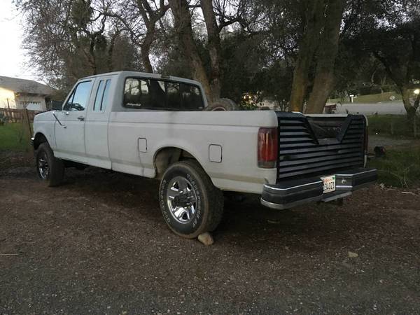

Just a quick question ...... looking to buy (if i can make it work) a turbo idi for towing/show off duties. Our rules over here state that for me to import and put on the road without converting to rhd , the vehicle needs to be under 3500kg (7716lb) glw - my question is , what is the glw of a diesel f250 like this one i found on cl , tried looking up vin which i scavenged off the license plate but it only gives me a band between 7001 and 8000 lbs.
https://sacramento.craigslist.org/cto/6061180972.html
7.3 idi banks turbo zf5 4x4 ext cab
