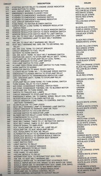

HELP I have a 77 f100 it was stole and they cut the switch plug off and dicarded it and i am unable to find one any where!!!!!!!!!!!!!! Is there anyone tat can tell me what wire goes where on the switch?:headbang:
You will probably have to hit the wreckers yard for one of those, if you are talking about the plug that goes into the ignition switch.
Each wire will have to be crimped, soldered and a piece of heatshrink placed over each splice if you want it to last.

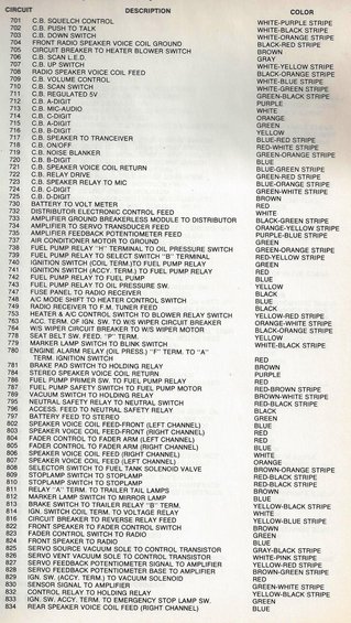

Should be able to figure out wire colors and where they go from this.
Ignition Switch C-412.
