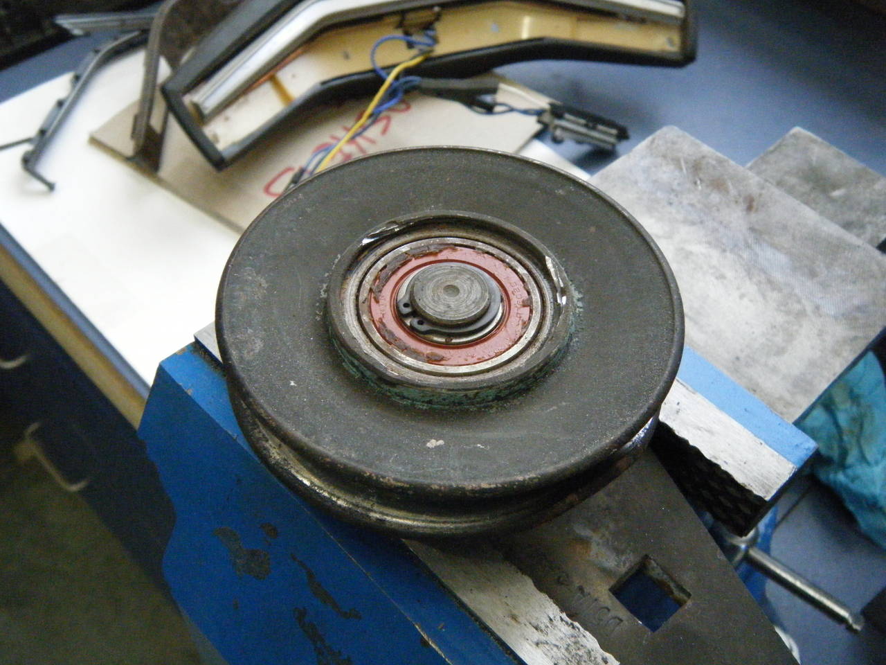

Got it apart today, went to Napa and looked at a replacement pulley for a dealer installed A/C, it was close but no cigar. Going to get them to bring the right one in and I will go and look at it and see if I can make it work on my OEM bracket.

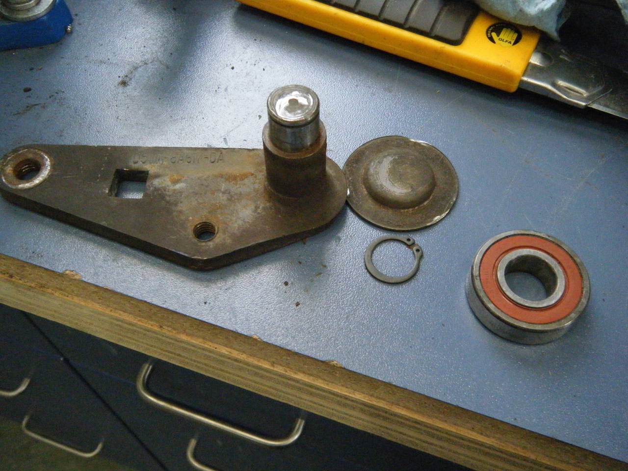

That's a 6203 bearing layin' right there with the red seal on it. :)
For some reason auto parts stores like to call 'em a "203" bearing.
(it's Fafnir and others number for them) 17x 35x 12mm
Shop around and find a good price on a name brand and replace it.
Put the metal cap back on with glue, if nothing else or leave it off,

Already sourced the bearing..problem is that I bent the pulley with my first attempt to get it off.
If you can bend it, you can bend it back? ;)
Butthead in AZ
ps- Did they call it a 6203 or a 203 bearing?
Possibly...but I put a bearing puller on it and once it was bent, I said screw it and cranked harder on it :D. I suppose I might be able to bend it back, but I'd be leery about stress fractures and the amount of time it would take as opposed to getting a new one......
Neither on the bearing..I called them and gave them the number, did tell me that it was a very common bearing though. Now the trick will be to get a USA made one.

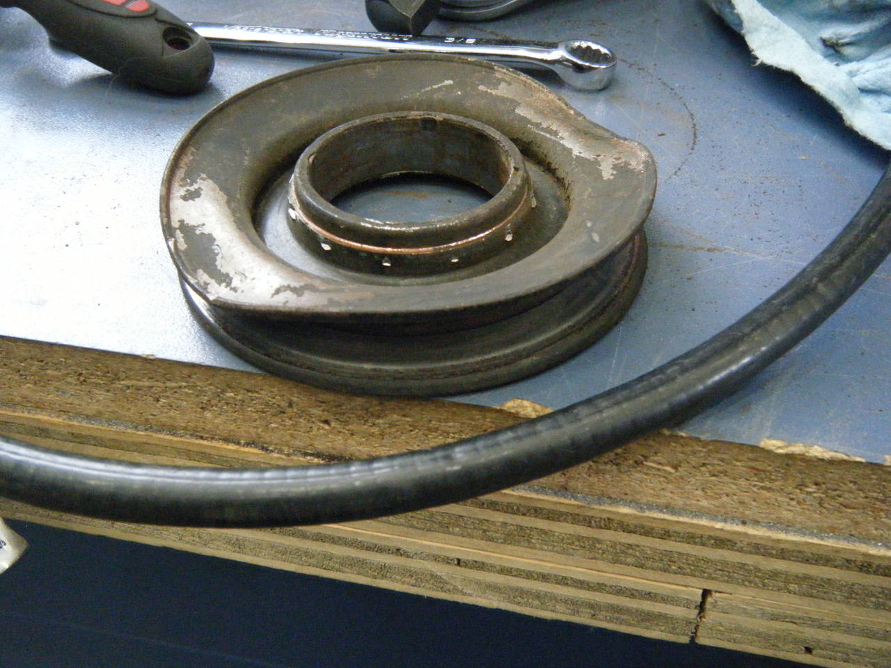

Rather bent, ain't it?
Bent is an understatement. Bet you wished you had you hydraulic press about now.
