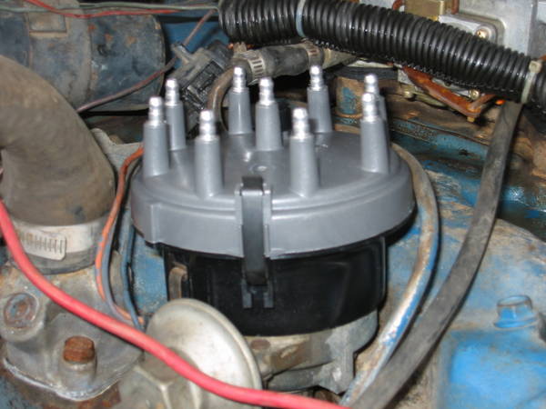

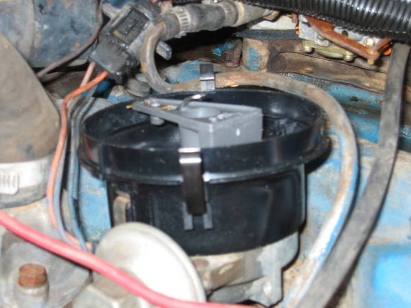

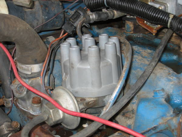

Thanks all for the help. Surewhynot mentioning the spacer, things started to sink in at that point. So I got the Cap, Rotor, Plugs, Wires done. Went with the newer( I think ) version and the following pics maybe will help out someone in the future.
Here's the old cap.
Here's the adapter.
And the different style cap.
