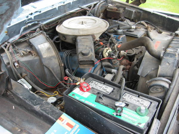

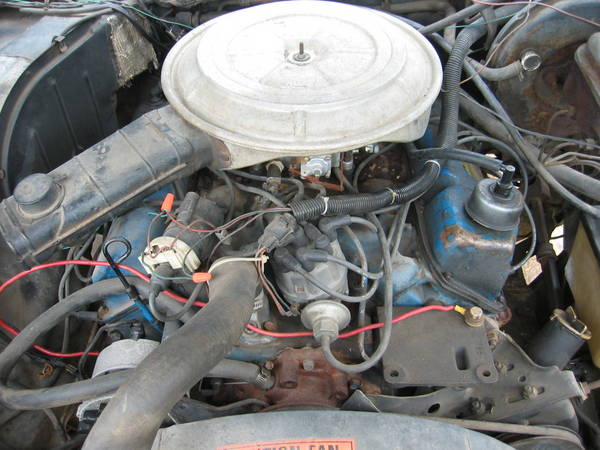

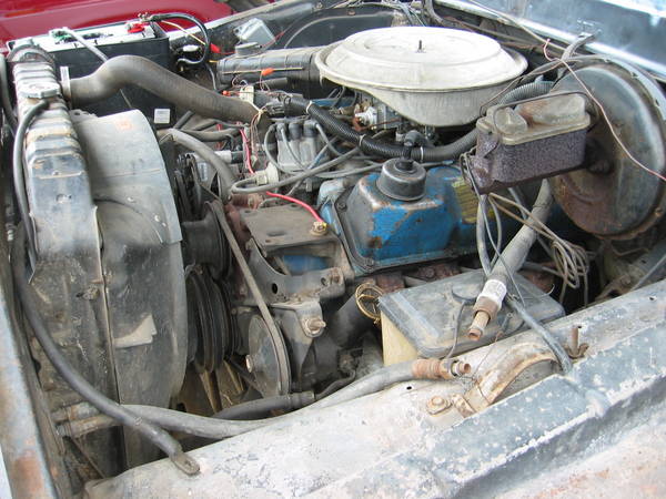

So I go to the parts store for Cap, rotor, wires, plugs. Tell him its a 79 f150 351m. cap, rotor, and wires not even close to what I took off. The ebayer listed it as a 400 then told me its a 351M went I get there to pick it up. Has 8 bolts on the valve covers. So how can I tell what it is? Am I right in thinking its a 351m or did the parts guy make a mistake.
A little more info. The cap he pulled off the shelve had a larger diameter and was shorter. the one thats on it now is taller and the connections are different. Maybe this is not a 79 motor?

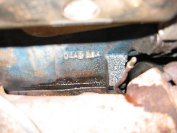

Gotta find the block stamping Rusty....no doubt if you have that info.

That is a 351m or 400.
The cap that they gave you will fit your distributor, but there is a spacer that goes under it. It also takes different wires. If you want the cap that you have now, get it for an earlier year.
When you say spacer could it also be called an adapter? Because they did have that just called it something different
