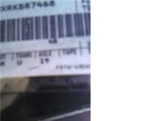

OK guys, i went to the junk yard, and i found multiple ford vehicles with MAF. Now heres my question, they was all 302's and the question is.... Will they work on a 351? Also i was worried about the PCM cuz i found a couple of F150s with MAF but a U code trans, and mines not that. So did T birds with the MAF 302's have E4OD's. I was to much in shock to really think straight. Im going to head back this saturday to get prices and shop around a little deeper.

There were 4r70 MAf trucks At least guy on other site had 1. I can't say personaly. as I never found a truck with any thing other than e4od.
These was all U code transmissions.
