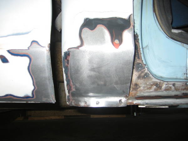

Not sure what direction I'm going at this time, but decided to remove some paint on the passenger cab corner to see how it looked underneath.
Not to bad. A little rust starting at the bottom edge, but very light and easily fixed. I'm thinking i need to worry about the running aspect of the truck more so than paint and body at this time, but we'll see.
I believe the start of the cab corners rusting out is from the inside and will show up first on the backside ( facing the bed ) just above the seam.
The condensation from inside the piller runs down and pools at that point.
Drill a small hole there to let it drain. Spray ospho down the piller
