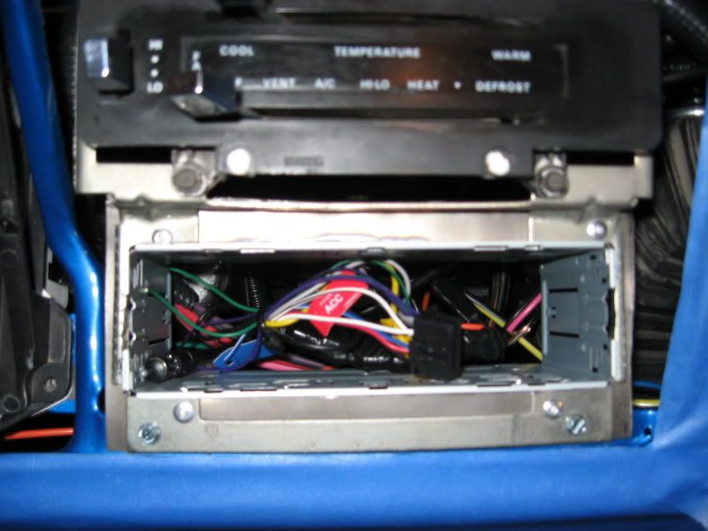

You'll have to modify the mounting bracket. Here is what I did. I took a piece of sheet metal and traced the DIN mount on that to cut a hole. Than took that sheet metal and and riveted it to the stock mounting bracket and then cut out what I needed of the stock bracket. The final product ended up like this. It's not the prettiest thing in the world but worked just fine.

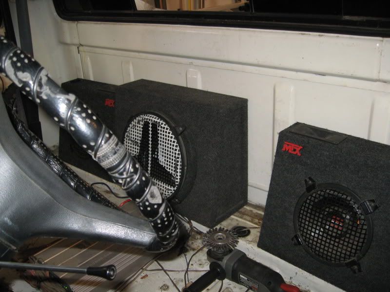

You can always put (as said) 6 1/2"s in the doors (running the wire is easy, even though you'll have to drill holes in the door and cab), two 3.5's fit in the dash nicely, an amp will fit inder the seat and there's plenty of room behid the seat. YelloThumbUp
I did as Buck did his HU install, measure twice and cut once.:beer:
EDIT: Found a Pic.
Also, if your CD player is really deep, the wiper motor might interfere with the installation. There are also "retro" shaft-style radios that have a connection to a cd changer. They fit in the old radio bracket without any modification, but they are pretty darn expensive($300).

ok so i did this:
made a bracket.
bought a JVC cd player. really nice.
6 1/2" phoenix gold speakers in the doors
tweeters in the doors
2 12" rockford fostgate punch P1 in a custom built box by me and my roommate
borrowed 280 watt MTX amp
it pounds reallly hard!! its crazy. so im happy it was worth the time and trouble!

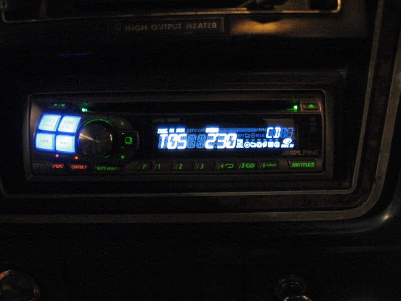

Sportin the JL Audio and Alpine FTW!!! Seems like Alpine just goes well with these trucks as I've seen plenty of Alpine systems in them (including mine) lol. Need me some good JL Audio though...
