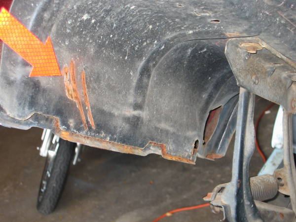

My hinge is flexing outward just enough to scratch the inside of the hood. Is it a good idea to try and bend it back in or will I take a chance on messing it up even more?

I'd try bending it back into shape a bit if possible. Better yet if you could round up a new set of hinges before you paint it would be even better. Those old hinges give out over time due to the weight of the hood. Good luck.
I don't see any harm in trying to bend them back...you'll be no worse off. But I agree, see if you can't find another set of hinges.
Yeah alright I'll try bending them back into shape a little. Got em all oiled up and they seem to open and close easier.

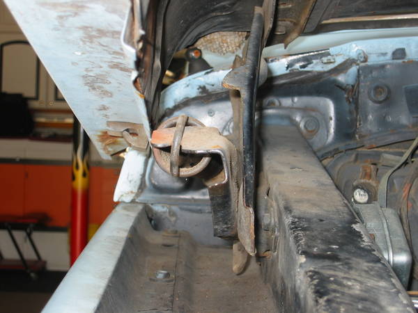

With the hood closed, does it sit level with the cowl, or is it higher?
If it sits slightly higher at the cowl, the hood flew up at some point, stretching the hood hinges.
This is a common problem that has affected 1961/79 trucks since all were new...you wanna know why?
Because the puny hinges are inadequate to support the hood, and ppl slammed the heavy hood down, sooner or later...usually sooner...the hood latch support sags...then the hood flies up.
Once the hood hinges stretch, they are HIS-TOR-EE.
1973/79 F100/350 & 1978/79 Bronco.

I'd try bending them back also, but usually when they start to bend like that, it won't be long before they bend again. Ideally, you should get some new hinges.

Try finding the special bracket they put on truck hinges of the truck that had a canopy or was a camper special.
You can see them here on my truck
