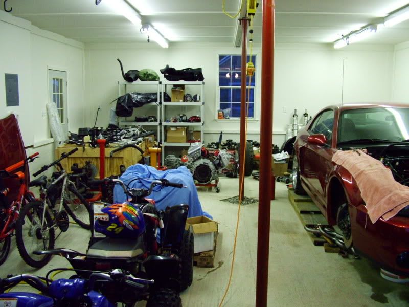

Kept the IRS of course! Actually, I set aside the complete factory drivetrain and built another separate engine, transmission and IRS rear to the specs I wanted. The motor was in the 650-700rwhp range....transmission was Viper spec with beefed up internals. The IRS got a serious makeover to the point the only parts factory were the cage and control arms.
Here is a couple when I was putting it together...

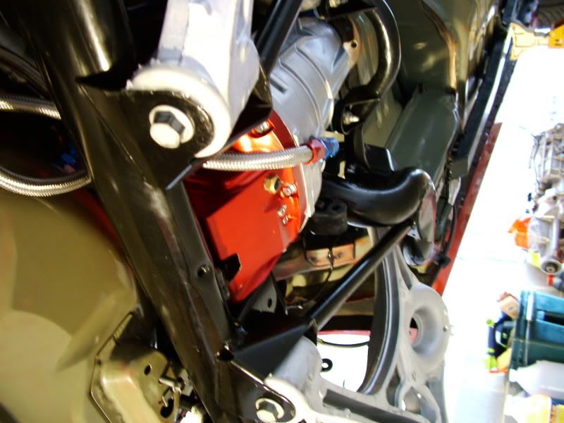

Another with the IRS in the car.....
And the last pic in the original set was the rear with the Baer brakes installed....4 piston...14" rotors. Very nice....spec'd to throw your eyeballs on the dash when needed.
There was nothing on the car I didn't modify.

Thanks....I learned a lot from a lot of other smarter folks too. Did a lot of research and homework to build it the way I thought it should be. Ask away....be glad to fill you in on anything you want to know.
I had a couple of sets of wheels....show and track. I ran 18" wheels for the most part. Rotors were 14" rebuildable front and back. Baer 6 piston calipers front and 4 piston rear.
