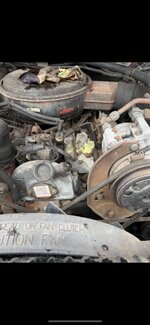

Can someone help me find what’s missing in this motor f350 super duty 1986 series
Jul 26, 2023 #1 1tonzilla 3 1 Lakeland Can someone help me find what’s missing in this motor f350 super duty 1986 series
Jul 26, 2023 #2 flareside_thunder Florida Chapter member 7,812 246 Looks pretty complete, is there anything in particular you're referring to?

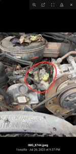

Jul 27, 2023 #4 flareside_thunder Florida Chapter member 7,812 246 No sir, it looks complete to me. If you're referring to this spot, that's where the fuel filters on the vans gets mounted.
Jul 28, 2023 Moderator #5 Fellro Moderator Staff member 8,013 393 Iowa County, Iowa Nope, that is the nature of a 6.9. You don't have the normal oil fill on the timing cover. These motors were also used in medium duty trucks so the air compressor mount and such would potentially use those mounting areas.
