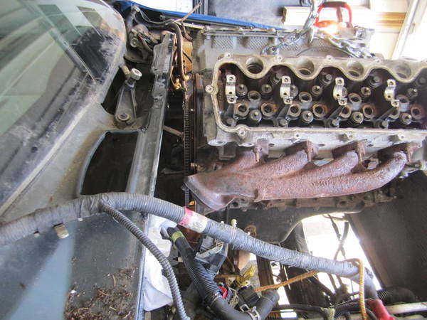

Well...This is kinda disappointing. Three of the caps that hold the cam down on right side are cracked in half. The journals on the cam are scored real bad. Out of the 12 lash adjusters only two will move freely.
Even if the heads are trashed, you might be able to get away with rebuilding the heads and leaving the block & bottom end alone?
Yeah that's still an option. Only thing is that price is creeping up there. And then I'd have a new top end and old bottom. May be better to have a remaned where everything is done and start fresh. Got some research to do. Figure out which direction to go.

Well I would most likely say the cap bridges Are cracked because some one try to put it on and didnt know what they were doing. Or tryed to bolt them on with the lifters and the Camshaft Followers in place under the cam.
As for the scoring. It could of been from that. Or more likely it was from the wrong oil. to thick of a oil or did a oil change every 10000 mile.
You cant just get some caps from a engine and put it on there. there a match to the heads when that make them. Your really going to have a really good head guy do them all over or just buy a reman head, A reman head from rockauto for that truck is 400 + 150 core.
But being the head is scored. I would look at the other head as well.
Other thing is your going to have the timing tool that goes on the carnk to time it right. OTC make a good one. and the timing marks on the chains is most likely not there any more as well. the chain has a black mark on 2 of the links on the chain to line up with the dots on chains,

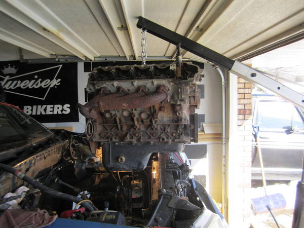

Starting to take everything apart getting ready to pull the motor. As the oil is draining out I take a look at it a few minutes later and WOW! I scramble to get my other drain pan. The one I'm using holds about 10 - 12 quarts and it's ready to overflow. And the consistency of the oil is not uniform. Light and dark patches that are not mixed together. By the condition of the motor I'm surprised the rest of the truck is in decent condition. Although I'm hoping they didn't touch the transmission.
Got the motor pulled last week. Not alot of room to work but i got it done.
Gained about two inches with the cowl removed.

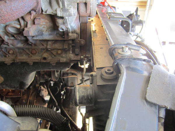

Left the radiator in. Have the disconnect tools but couldnt get the lines removed.
Some thing else i didnt think about. with the arm extended all the way out at full height it hit my garage door. the pan needed about three inches more to clear the core support. Remove front tires and lower it onto small jack stands? that would work but, my only jack was holding up the trans. what to do, what to do? Let the air out of the tires. lol.
