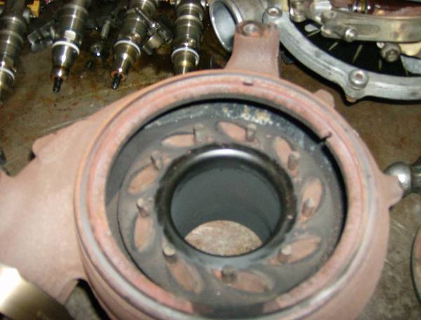

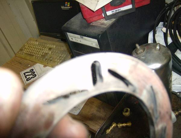

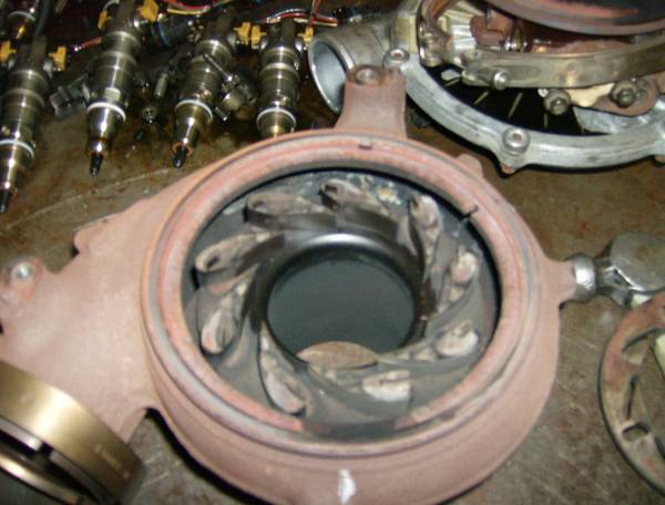

The first thing for me is to remove carbon and hard deposits on the heads and deck surface. Then break out the feeler gauges and the straightedge. From there, start to refurbish the turbo. Fom there, order parts as needed.

Just out of curiosity Venice, whats a repair like that run from Ford??
Much of it depends on the parts you find that are defective. Theres no way you can give an accurate estimate, because you can't tell whats worn out until you take it apart.
