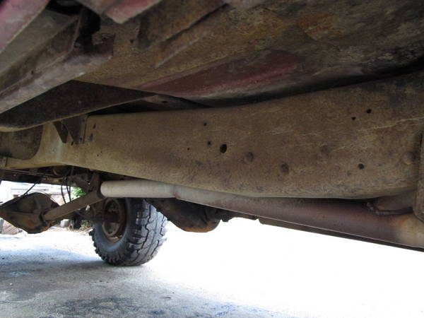

Stock exhaust , but the Previous Owner cut it off. If you look closely you can see in the pictures below....clearer in the second picture.
Is the relay or the fact that I have the end of the exhaust cut off have anything to do with this?

i was just trying to rule out the starter getting hot or one of the connections or wires being exposed to excess heat.
i had a cadillac that had an exhaust leak and it would cook the starter. started fine cold, but once driven i had to let it cool back down to restart.
