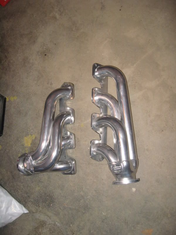

I went with the Sandersons. http://www.sandersonheaders.com/index.php They're not a mainstream company, and not many are aware that there are shorties availible for these era of truck/engine combo. They're a little more spendy but the quality is top notch, and the flanges are 5\8" thick. Since putting mine on over a year ago I've had zero issues with leaks.
Some pics.
Flange difference between the Sanderson's and the Heddmans.
