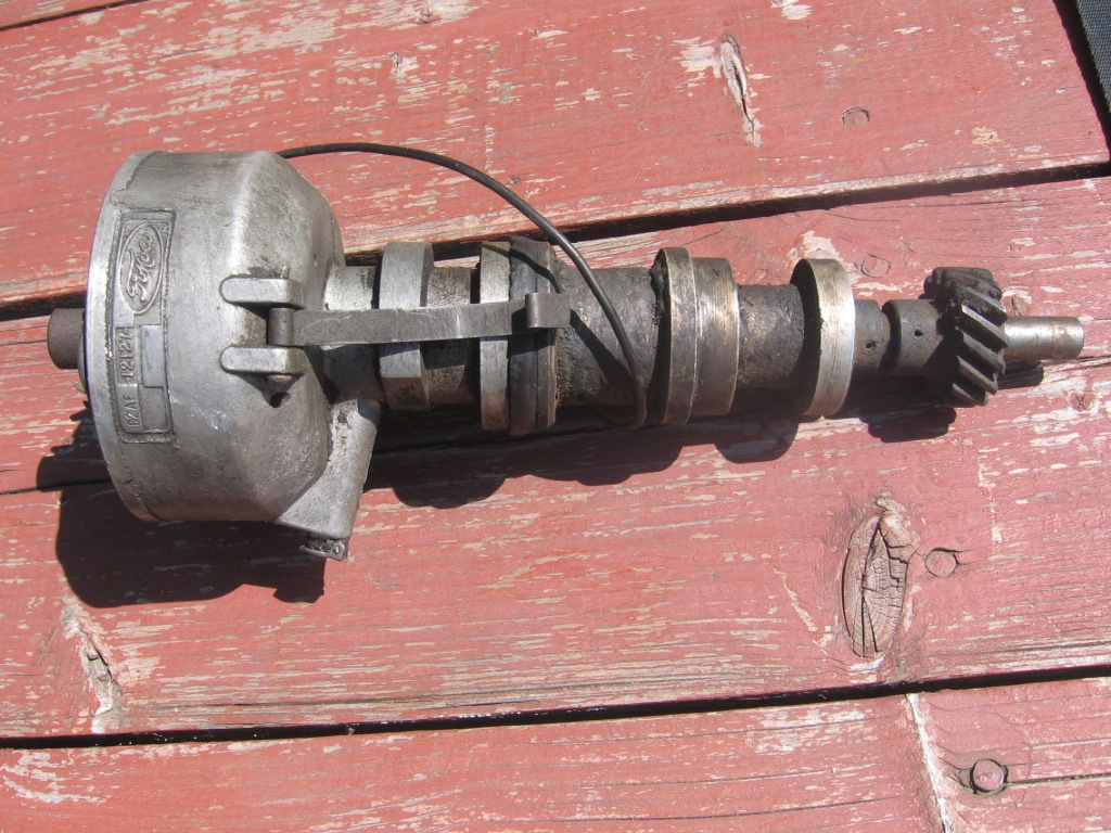

I have the following numbers for the distributor: Motorcraft 12127
Additionally, there are ten (10) bolts holding the heads on, not eight (8).
Thanks again. Let me know what you find!

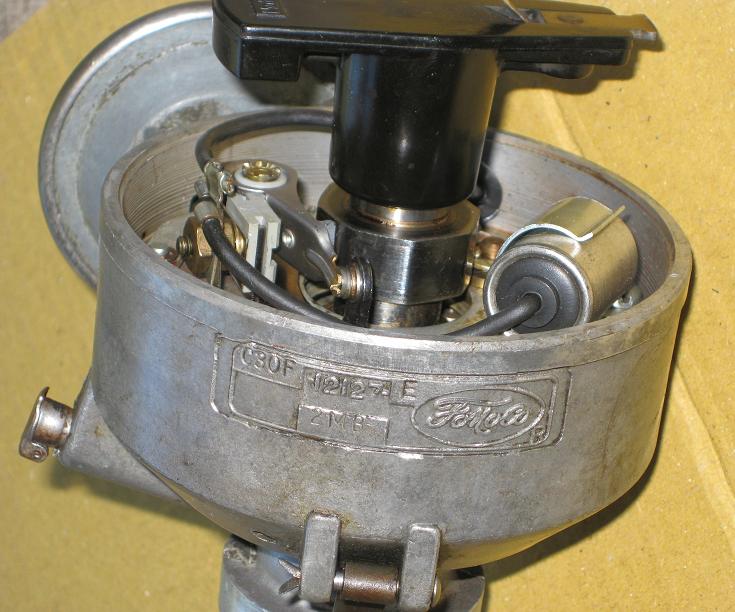

Are there any letters behind that 12xxx number?
I need the suffix after 12127
Plus the numbers before it.

DOAF 12131 A <---that's from the dist. shaft But, it's possible that the "F" is actually an "E"...just worn. And there are 6 valve cover bolts.
I need the number from the tag or from the housing to give you the actual Distributor number.
That shaft looks like it fits the 400 and 351M
You still haven't answered what I have asked of you.

This truck has been "handled" by too many people in between. There are NO tags. When you say you need the number from the housing, which housing are you talking about? Additionally, the thermostat housing attaches to the intake manifold on this engine.
Wouldnt d0 indicate 1970?....i looked in my book and couldnt find that exact number....i will look again tomorrow more closely
There should be a number stamped into the housing on the top near weher the cap mates
ie: D8AF-12127-AB
