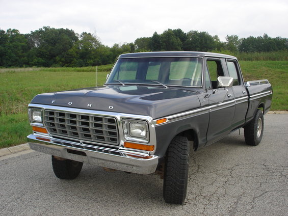

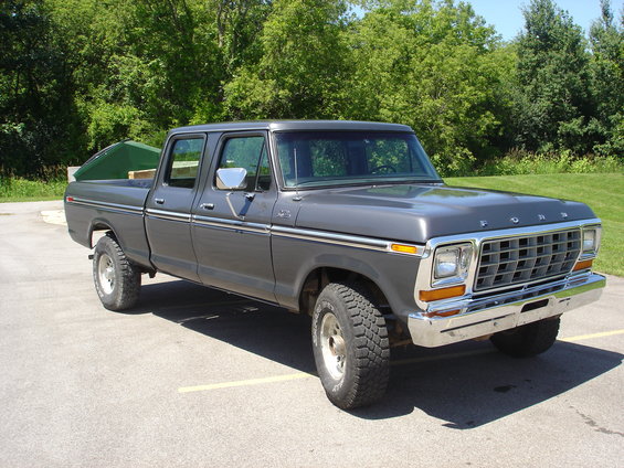

Headliners up.
And the windshield is in. I decided to also wash it for the first time today.
What material is that for headliner? And is this one going to get any lift treatment?
885
53
That is black leather. It's a bit dirty from being around the shop and needs to be cleaned good. I've got a steamer as well so I'm going to try that on it to see if it will tighten it up a bit.
Lift? Good question, I really haven't decided yet. If anything I will add a spring up front to level it out and new wheels and tires are planned. Probably going to stay the height it is and run a set of 33's.
Very impressive YelloThumbUp
885
53
A leather head liner, and big piece at that. NICE.
I installed one of those map lights in my SC, Besides adding needed light
it helped hold up the headliner.
Actually that leather was cheaper than I thought. At the fabric store I think the total with the padding was only around 75 bucks. My thought exactly for the dome light to, I knew it would need something in the middle to help support it.
looks great Scott....
Thanks Bob, now get to work on yours!
885
53

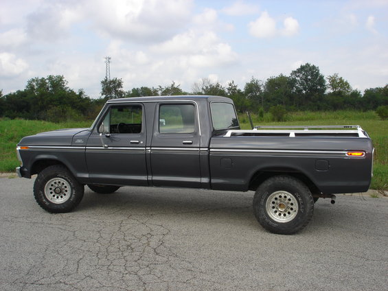

Just a little update.
I got the windshield trim on. I found a set of factory Ford bedside rails I put on. I still have to pull the front doors off and drill the holes needed for running the factory speaker wiring. Once that is done I can finish up the interior. I got the rear doors aligned finally. What a pain in the *** those were. Next on the agenda is to put down some Al's liner in the bed. I'm going to color tint it to match the truck. I also need to buy a new set of wheels and tires but with the way work has been they will probably wait till next year before I spend the coin on that.
