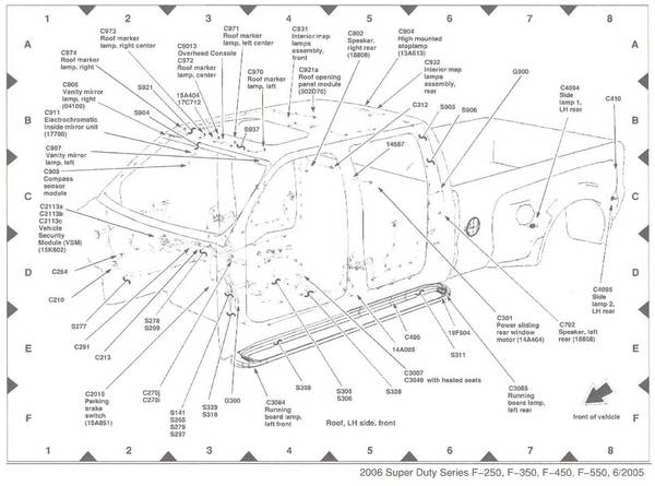

I'm trying to find the security computer inside a 2006 F250, I need to get the keyless entry code off of it. In my bronco there's a nice black box plainly marked under the dash, I've tried looking there, pass kick panel, under the steering wheel, behind glove box, any one have any idea where this computer lives?:beer:

Standard cab or crew/supercab?
Here is what I found: Standard cab...drivers side behind seat there is a little door.
crew/supercab: in the rear seat back. Have to open it up to get to it.
DO NOT tear into your seat until somone who really knows answers this post. That is just what I am finding online. Never believe everything you read online.
