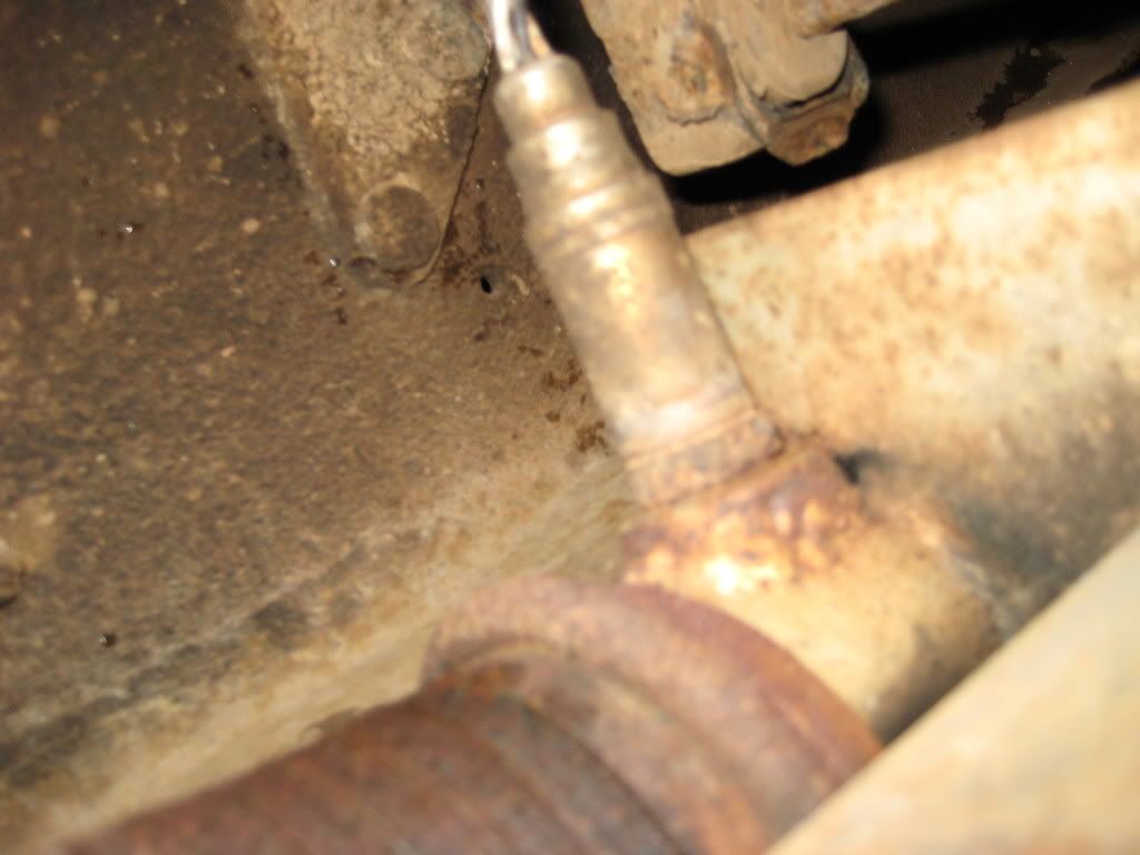

92 F150 5.0 E4OD
This is how I have it on the 95 F350 5.8 E4OD

is it hot in here or is your 92 sweatin' LOL Jk. Thanks for the pictures! Im just kickin around putting an X pipe and running duals on my truck.. I think that would sound a bit better..
My white truck sounds better then my stang. Stang got x pipe
