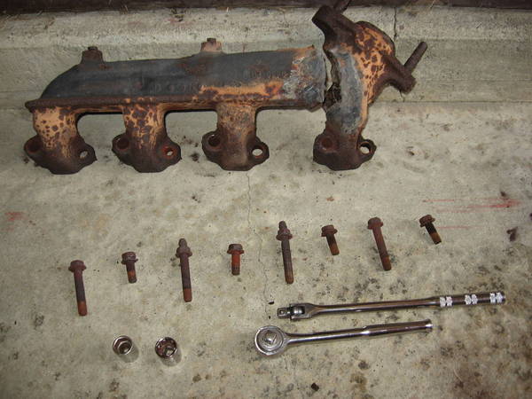

A day before you are going to remove the manifolds, spray some WD-40 or PB Blaster on the bolts. The next day start up the engine and let it warm up, then shut off. This will get heat into the exhaust bolts. Using a small breaker bar, just 'crack' the bolts loose, you will be surprised that it's not that bad for them to break free. I just bumped the breaker bar with my palm, do NOT use full force on the bar. Then let the engine cool down so you can handle the rest of the removal without burning your hands. I had the same issue with my cast manifolds and put on shorty headers. The only thing I wished is that I did it sooner. I have pic's in my gallery of the removal.
Here's one pic showing the manifold removed. I used only a 3/8" breaker bar.
