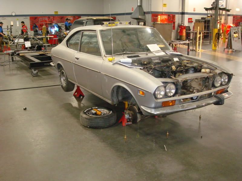

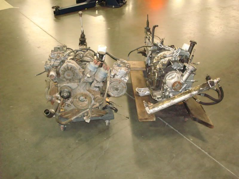

Working on this in class, car is a '73 RX2 swapping in a 13b from an '88 RX7.
Not mine but one of the guys that works at the school, it was his grandfather's and he wants to get it running again. He's keeping the swap low buck so that means a bit more work than the normal swap for these cars...
Getting a gist of what I need to do

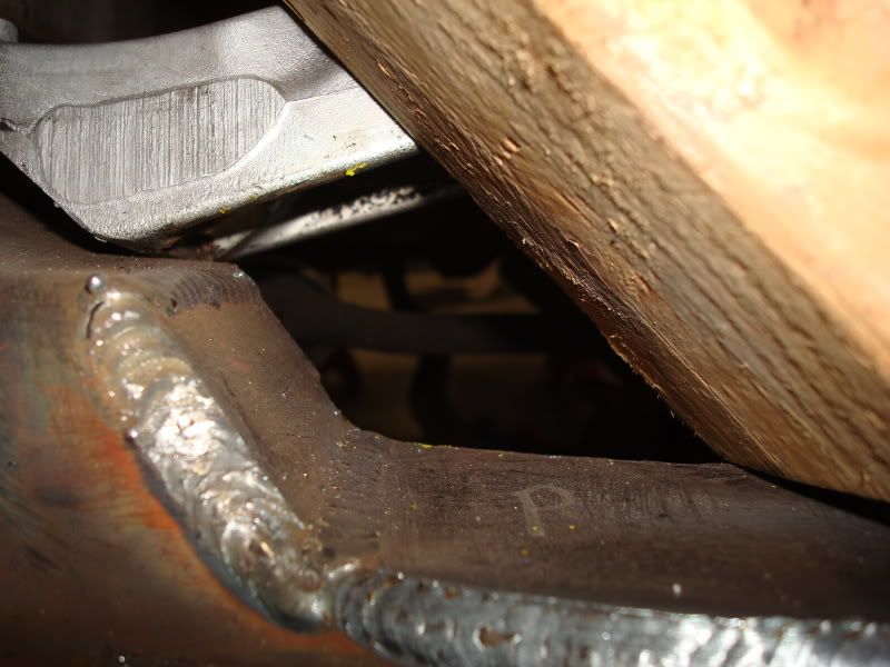

More pics:

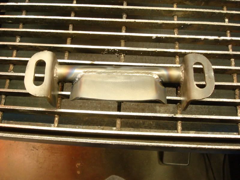

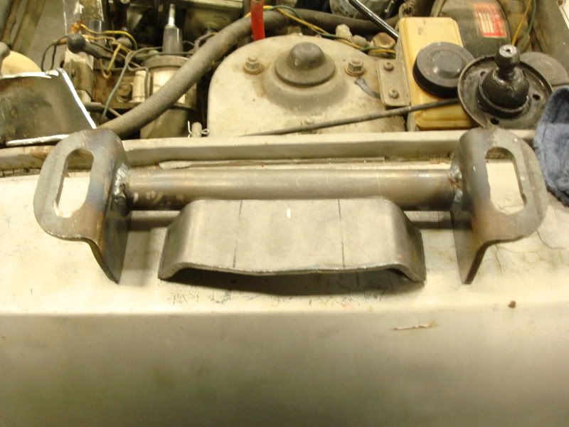

Finished engine cross member

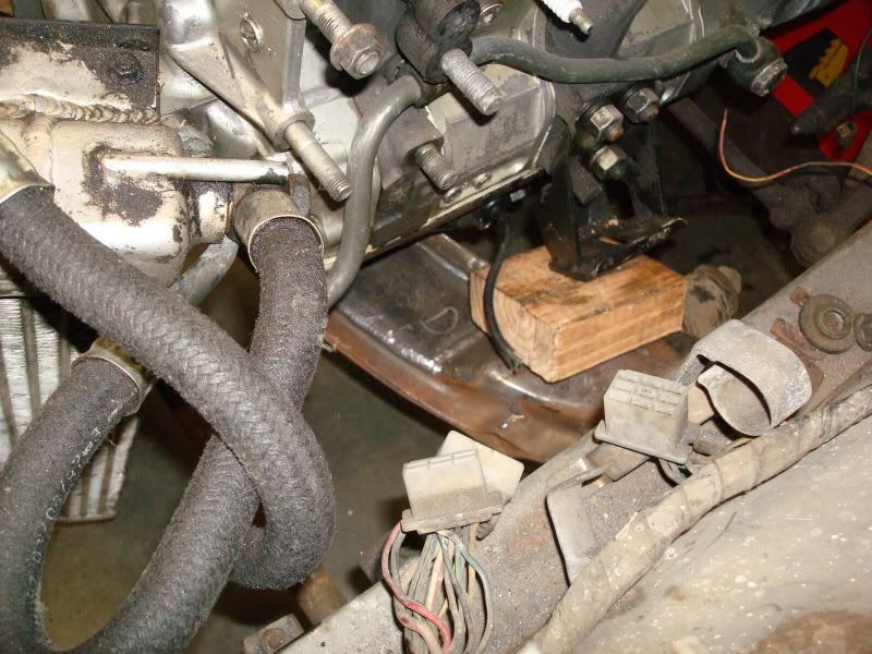

The gap is about an inch-ish, minimum needed is about 3/8"-1/2"...

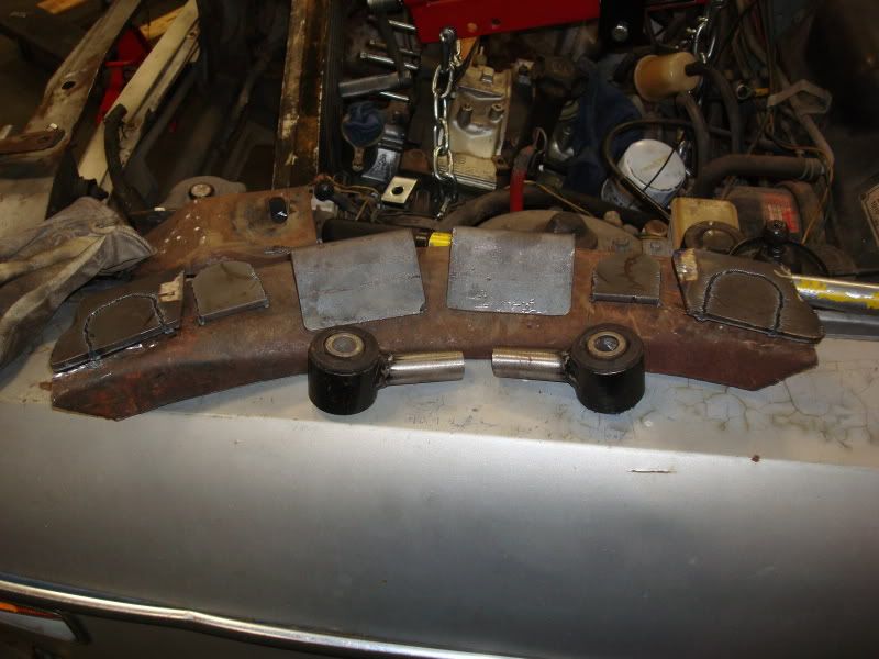

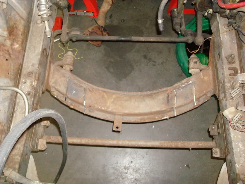

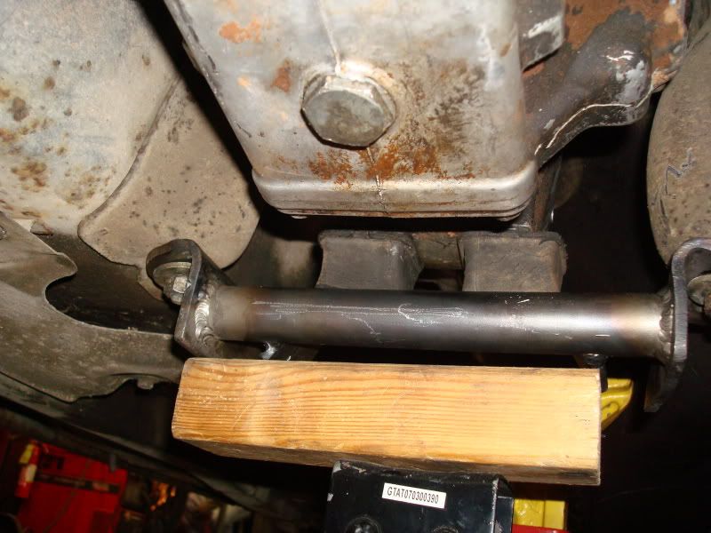

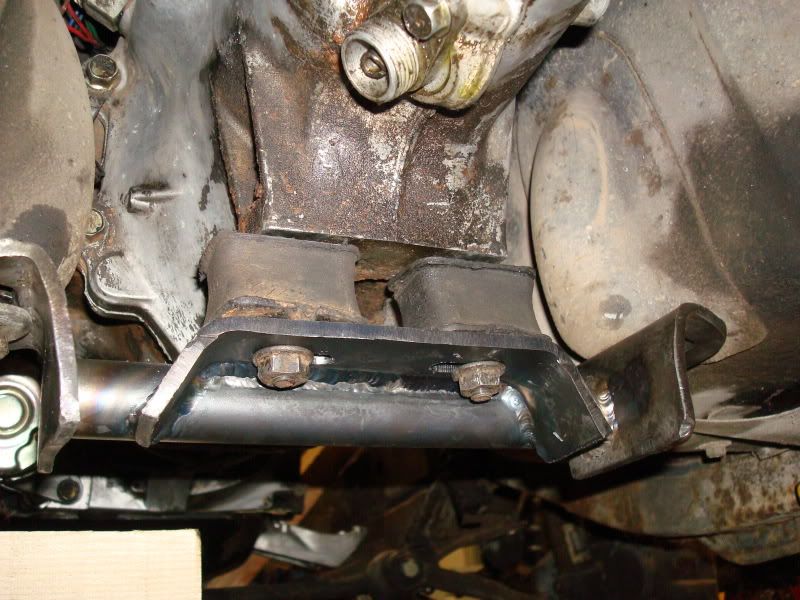

Trans Mount
My initial design
What I ended up with

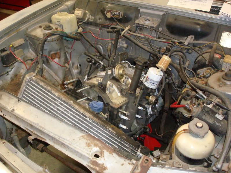

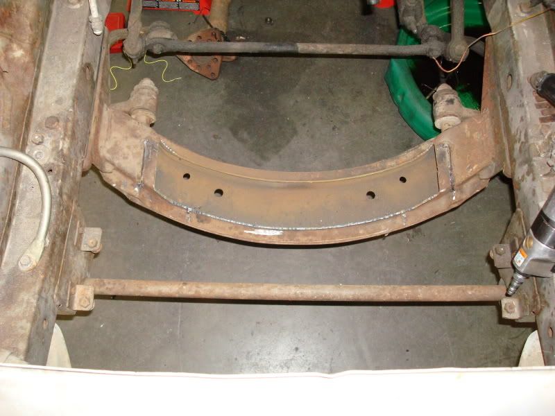

I'm working on engine perches and mounts now,

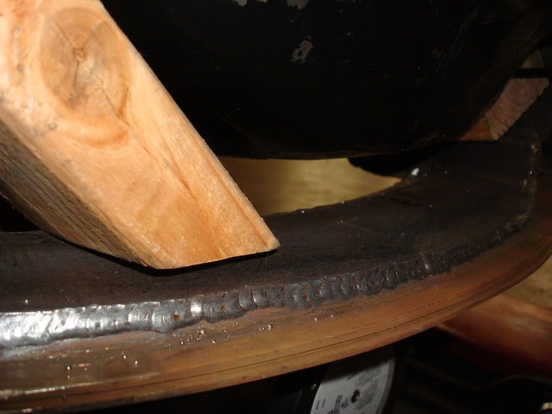

Looks nice, but you could have at least used pressure treated...
