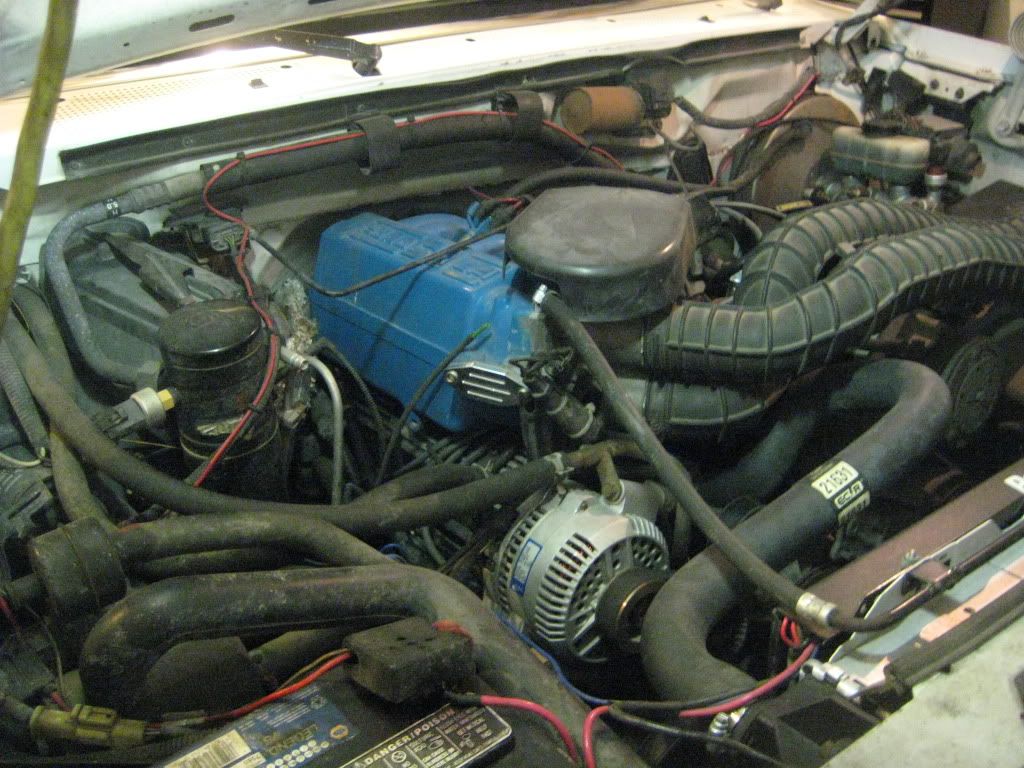

Well the piece I fabricated disintegrated and then the compression fitting rolled out while I was driving. :rofl: It's time for me to order the whole kit!!!

All said and done was about 47 bucks.
I can't be very accurate about power gains. If there are any it's not noticable (but the small stuff does add up). My problem is that I had it running with an open header for the EGR port after my tube that I fabricated disintegrated. So I ran it stock, then modified with my part, then my part fell off, then I 'fixed' it with these parts.
Unfortunately I now I have CEL. The dummy part they sent me is not doing what it was promised to do. It is, however, running smooth as silk.

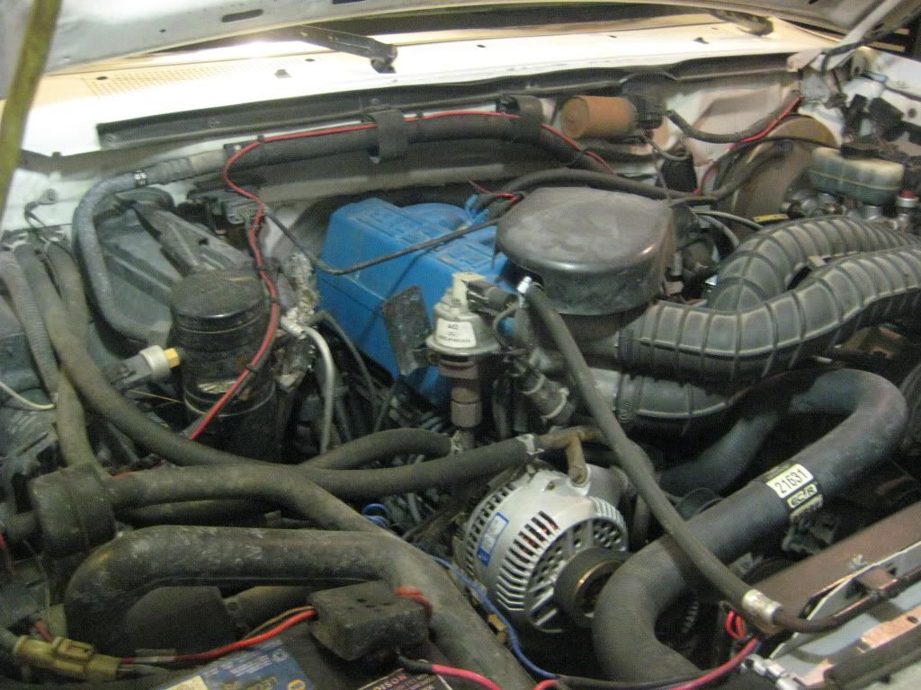

During my experimenting with the '91 F150 I found the hole in the plenum
chamber to be "close enough" to the right size for 3/8" tapered pipe.
So I just tapped it and screwed a plug in it. :) A 5th grade neighbor-boy
was over so that made it fun. :) I'd run it in and ask 'im if it was enough.
...and do whatever he said. Stop and try it or keep going. He did good
after a few tries, the plug went in flush as anything. LOL :)
Was using a 1/2" speed-handle with a 3/8" drive reducer and a socket on
it for the tap and an Allen "socket" for the plug.
A guy -could- screw the EGR head right-back-down, if needs be. ;)
