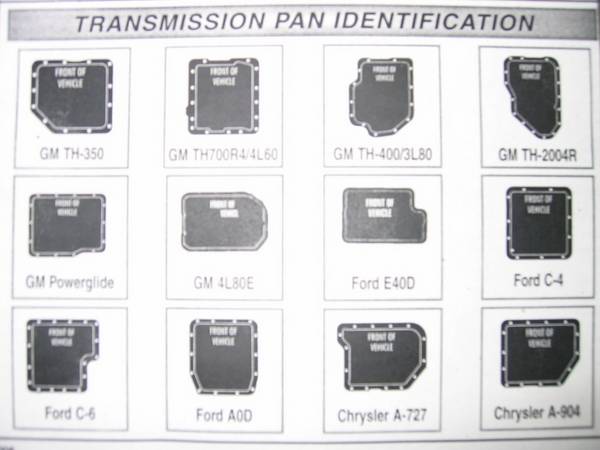

How come we keep talking about the 4R70W/AODE when he says he has an E4OD? They are completely different transmissions. If the pan is almost a square its a 4R70W/AODE/AOD, if it is a rectangle with a cornoer cut out its an E4OD/4R100. I suggest that you check the MLP/TR sensor on the drivers side of the trans and see if there is any moisture in side the connector. They get moisture in them and short them out and cause all kinds of trans issues with or with out setting codes. This is a very common problem and if this is your trouble get some dielectric grease from the parts store and put some inside the electrical connector to help seal out the moisture/water.
