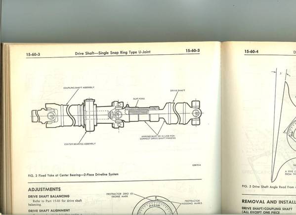

I ran into a snag while trying to line up the universal caps (snap rings) on my two piece DS. On the front shaft, rear splines/yoke, the yoke will end up 1 gear off of being lined up. (I had it 90* out ). And I can't find anything in the shop manual other then lining up the universal caps. Anybody know another way ?

Heres the picture a little bigger.The slip yoke has been reinstalled so that the 2nd half of the DS (rear) is phased correctly. The snap rings face you just like the picture. ( the right side)
The front half ( left side) ends up with the u-bolt cap lining up with the snap ring cap unlike the picture. But the universals still all face the same. The dotted lines that are under the "center bearing assembly" is where the splines are that won't allow the snap rings to line up as in the picture. As far as I can determine , it's physically impossible to do as it shows in the manual.
just like the picture. (the right side)
The front half (left side) ends up with the u-bolt cap lining up with the snap

Looks like it's just bolted in the picture??
