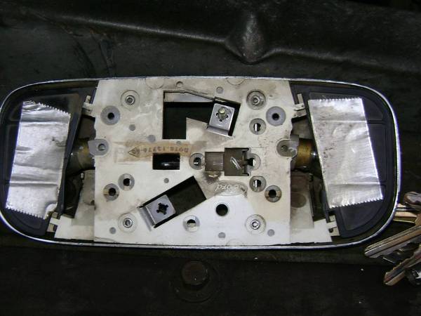

Alright guys...I'm having some issues with my dome light install in the Bronco. Dunno if I'm stupid or what. First off, I can't get the damn lights to come on. I've got power to housing and when hooked directly to a 12v source the light comes on. I used a ground wire from the housing to a good ground. Then tried putting the hot every damn place I could...and I couldn't get the light to come on. It appears I have power to the socket...but it's actually the socket and not the little plate that the bottom of the bulb sits on. So if any of that made sense, or you know where the wires need to be to make this thing work, lemme know. FWIW...I was just dealing with the map lights, the actual dome light was blown. Here's what I'm working with:

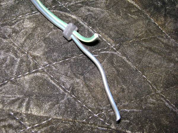

Can't remember from last night, but I believe the green is hot all the time and blue is only hot when the headlight knob is switched on:
Seeing as I don't have the stock ends to those wires, I was just going to solder the wires to the proper contact. But I don't have a damn clue which wire goes where. HELP!!!!! Then it needs to be grounded as well, suggestions?
It's hard to tell from that pic Ben, but follow where the wire or copper trace goes from the center pin on the lamp....that will be where the hot goes.
Likewise for the ground...follow from where the outer shell of the lamp goes...that will be the neg...I think this is what you are asking?
What I'm asking is...the two wires where in the hell do whose two wires go? One is hot all the time and one is hot only when the headlight switch is turned. I tried everywhere on that lamp. I got power to the socket, but couldn't get the bulb to light up. I also used a jumper to ground it. I figured if I had power to the socket, the bulb would light up. Right?
As for the ground...I believe that is gonna be separate. I was thinking of just using a wire soldered to the inner housing and then screwed into the roof.

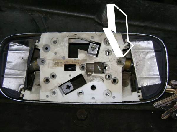

If you can get a chassis/body ground connected to the connection of the lamp base (white arrow), the whole of the grounding in the dome light should be complete. The two tabs would constitute your pos connections, I'd think here-
UNLESS it's a loop-connect; The power passes thru the lamp and the return lead goes to the door switch that grounds it out. seems to me that is the case- IIRC. Two-pin door switches were a while later in coming. turning the headlight knob also completes the connection to ground.
What tabs are you talking about for the pos connections? The ones that look like they have 'cross hairs' in the middle?
As for the door switch...that may be included in ground...I dunno, but those plugs and wires are all I have and don't see any provisions to go to the door switch.
Yes, with the crosses :) And it's just speculation- you've checked BOTH wires for power, right? You said the green has power all the time, but there'd have to be a control switch on the lamp for a constant hot to have value. Is it hot all the time because the door is open, perhaps? just askin'/sayin' lol... wish I was there- Easier to look than to ask- hehe
