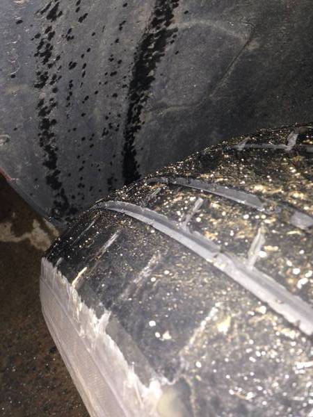

Drove Bailee's Edge for the first time in about 6 months for a 400 mile round trip. I get around to the drivers side, notice a pretty severe wear pattern on her less than 5,000 mile old tires. In about a mile and a half I notice a front end wobble from the drivers side. I ask her how long it's been wobbling, she said a couple months (doh...facepalm). Anyway, the steering wheel isn't true, and when driving, when I approach true, it starts wobbling pretty fiercely, when I go left of true, it goes away...when I'm traveling straight there's a little wobble in the wheel...turning to the right, absolutely zero issues. Wobble also seems to be there sometimes upon brake application, but I couldn't always duplicate it. Since I have no idea what the front end composition is like on these things...what do I need to look at??? And will it be something I can accomplish in my driveway???

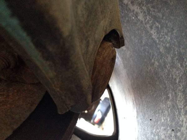

Tire wear:
How far from true the wheel is:
Frig...I just edited those photos to be rightside up. I give up.
I'd say you need to get a wheel alignment done Ben looking at the wear pattern on your tyre.
For the wobble issue i'd jack up the front of the truck and slowly spin the wheel looking for any bulges or depressions in the sidewalls of the tyres also check for any flat spots in the tread - it sounds like you may have a broken steel belt (commonly caused by dropping a wheel into the gutter hard or striking a large pothole at speed) in one of the tyres to induce that wobble or if the wobble is not that bad one of the wheels is very much out of balance.

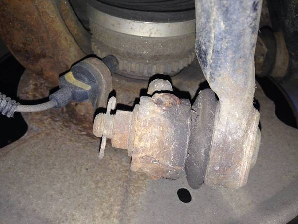

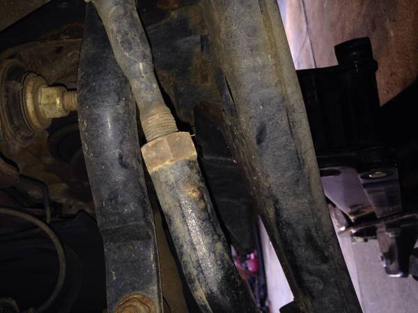

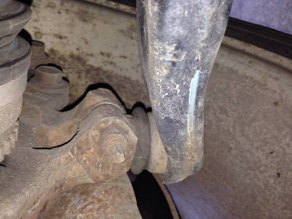

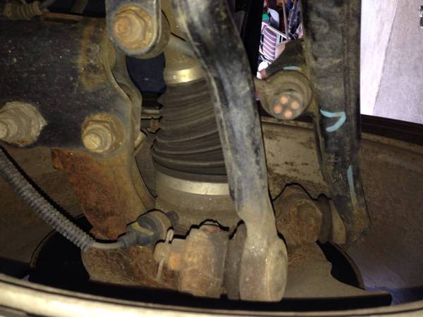

Alright guys...what am I missing??? Turned the wheel side to side...didn't see any play in anything. Lifted the front end...no play front/back or top/bottom with the tire. Put my hands on everything and couldn't get any play. Snapped some pics and nothing really looks bad to me...thoughs???
Anything with a joint I yanked on with everything I have...no movement. I'll give the tires a shot...just wasn't sure a busted belt would cause that crazy wear pattern.

Actually, broken belts cause all kinds of interesting wear patterns. You can typically find the broken area by the tread wearing more at those points. They will cause a wobble sometimes when driving slow, under 20 mph, and can cause shakes/wobbles when applying brakes hard at road speed. they also make shakes like a bad balance.

Thanks mark...did the steering wheel turn last night...nadda. Yanked on anything I could put my hands on...no play. Didn't see any eggs. Putting the tires on a balancer right now too to double check the belt situation.
Alright...well I'm back, after almost having to make a few people eat a tire iron so I could get a tire on a balancer...tires all came back with no bad belts.
So at this point I reckon I'll get back under it tomorrow and start taking it apart. I mean, it's only a strut, ball joint, control arm and a couple link ends.
Alright...so I did a little more digging...read online that with the push pull, derivatives of problems can start from the opposite side. Lifted the front end of the Edge up...sure as all things that are holy...the passenger side outer tie rod is garbage. I woulda never guessed. Sound plausible???
