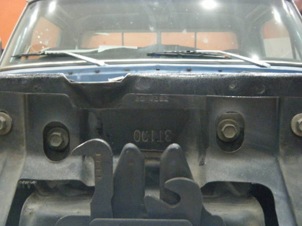

Thanks Dennis....I just went and had a look. There is indeed a number on the grille surround right where you said it would be..it is 9C78F...the "F" kinda looks like the old Firestone tire F. There is a number right in the middle of the hood latch that is 10 13B2. Do these seem like Ford numbers to you?

Yes those look like the Ford #'s.
"10 13B2" are you sure those are correct.
16139 A? is the engineering code for the Radiator support 16138 is part of the part number or older engineering code.
Most of those others are date codes.

Absolutely positive Dennis....I'll post a pic....I can't find a number on the actual rad support
It is the top number.

There is no 6 in the combination...the top number reads 10 13B2...I wish the camera could focus in more but I've tried 3 or 4 times...but my eyes are good and that is 100% for sure what it reads.

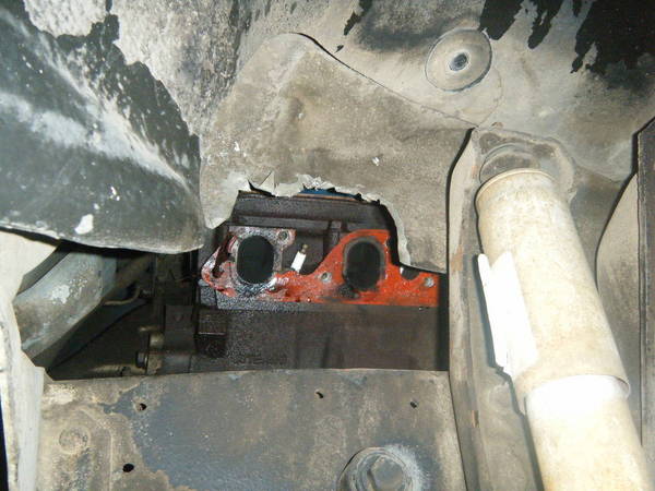

I found out why the inner fender was a bit butchered...a heli-coil had been installed for a header bolt. Hat's off to whomever installed the headers though..anti-sieze liberally coated on the threads...easy to remove.

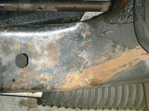

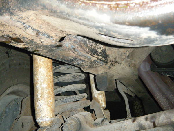

This is the right side of the front crossmember...you can see a crease at the top (closest to engine)

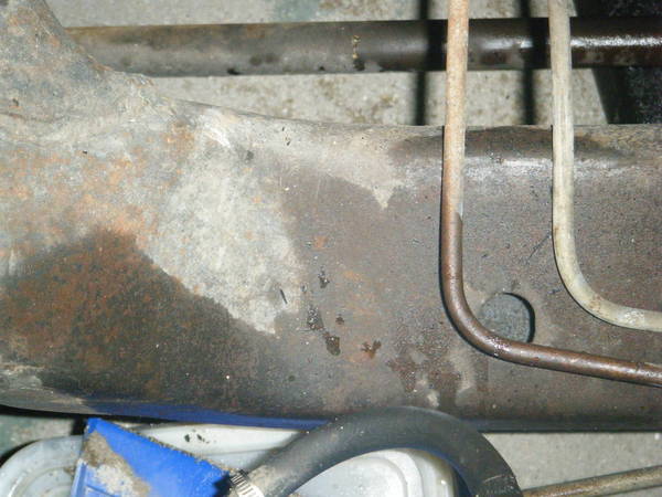

This is the other side (passenger) where the sloppy welds are and it is also about 3/8'' closer to the cab than the other side:

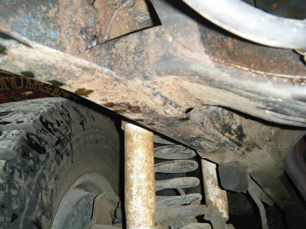

This is looking straight down from the grille...it looks like more than 3/8 but in reality could even be closer to 1/4, it looks deceiving..at least that's what my measurments tell me anyway.

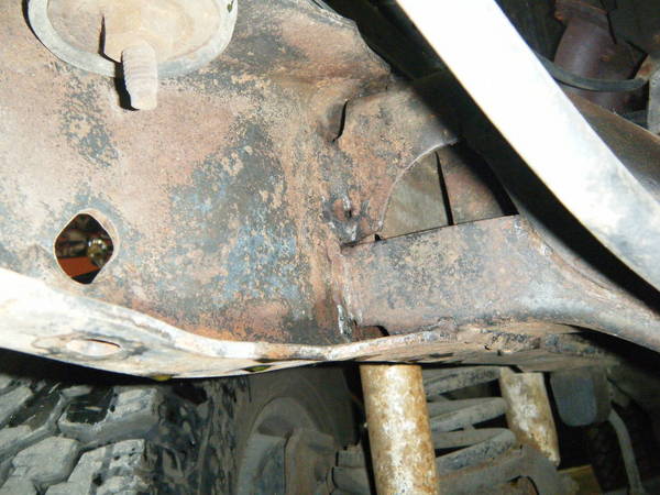

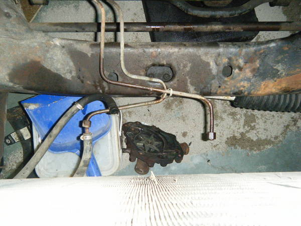

The following are pics of the ahem "welds":
So now I'm having a dilemna...do I just do some grinding and fix up the welds?...I'm a little leery shoving a 550HP+ engine in and leaving it....or do I do frame off restoration? The rest of the frame looks fine as is the body...this is gonna take some thought...all input appreciated!..pics are in my gallery if you need them enlarged.

Those crossmembers were never straight across and always had a bit of an offset to them. Personally I'd leave it alone, they look like factory welds to me.
