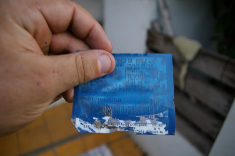

decode this vin ?
i wanna know what axle its got LS ? or POSI or open!?
1ftdf15y11na53611

I can't read the VIN correctly from that picture... But even if I could, the vin will not tell you what your gear ratio is. You have to look at the axle number on the door sticker or the tag on the rear diff. Can't tell if the code is still visible on that tag. Otherwise you'll need to crack the diff and count the teeth.
KdPate
After Hours Garage
Looks like it has an axle code of "19" if that is the decal from the door jam.. Think this was a 3.55 gear with open carrier[confused]
