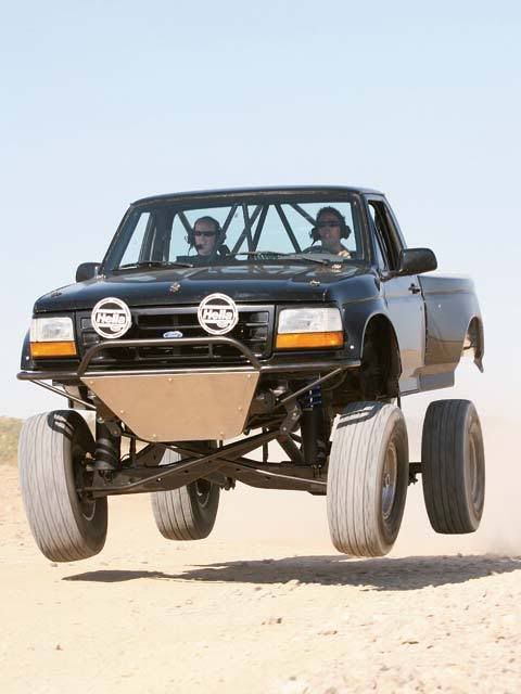

In my opinion the twin I-Beam and/or ttb design has proven itself ten times over in desert racing and is great for anything your doing. if your camber is off slightly and its waring your tires down in an undesirable way you can buy the degree bushings. id only change to the solid for the looks. for some reason it just looks better with a lift.

Desert racing generally utilizes a twin I beam 2wd setup rather than a TTB functional front axle setup. The issues with TTB come not from the ride quality but from the lack of strength that any independent front axle system has

Good call Roger. Yeah with the design of the ttb being on hinges, if you lift up the front end then the tires will do this \---/ and if you put weight on it then they'll very slightly do this /---\. Here's what I mean-- notice the angle of my tires after I lifted the truck by the frame:
Here's a better view
And that's is a true First Gen Lightning...
