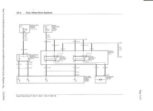

If you're sure the power supply is ok (fuses) there is a 4x4 control module behind the glovebox. Theres 2 connectors on it.
