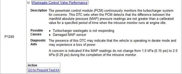

Well, the check engine light is on with code 1249. I believe this indicates waste gate control valve performance.
The truck is a 2011 f250 w/ the 6.7
The turbo was dumping pressure normally, now not at all after the engine is shut down.
TIA for any constructive advice on the repair.

So, the problem is fixed, maybe. The tech initially felt the turbo was not building pressure properly. He ended up replacingBC3Z 9E882 A Solenoid which was the inoperative wastegate solenoid. He also told the service writer the problem may re-occur due a weak EGR? (I did not have the time to speak with the tech).
The engine light is off after 100 miles. Before the problem, a noticeable noise was present for 20 seconds or so as the turbo pressure was released at engine shutdown. After the fix, the noise is not present. We shall see where this goes.
