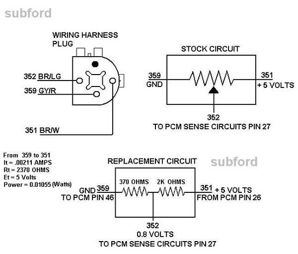

Is the EGR valve still there with a blank behind it but still wired up with a vacuum line to it?
Or is there a resister network plugged into the sensor plug?
If you do not have a resister network or the valve still there with a block off blank then you will get the CEL (MIL) light when the engine reaches operating temp at mid throttle and will go out at WOT or idle.

no the vacuum stuff over there by the coil has been removed ... never saw them and vacuum from egr is blocked.. but yes! it is still plucked in.. ive been searching whats the resistance i need to put there? can you show me what i need and wich pins to connect it to.. i just need the risistance i can make it myself at school

i just did the KOEO chek and it gave me
81
82
85
84
had those for a long time now.. since all the emissions stuff is gone.. never gave me a prob,
repeated that once more and then a separation code and got the
33 EGR valve opening not detected.
41 HEGO sensor circuit indicates system lean (right side).
now the 41 is a new code for me never had that one before.. as for the EGR i saw one time somehwere a thing to buy to bypass it im going to search for it.. i dont wanna do something on my own risk and frie something lol.
nway ass for the code 41 what now?
EDIT :
here we go
http://rjminjectiontech.com/?p=9
