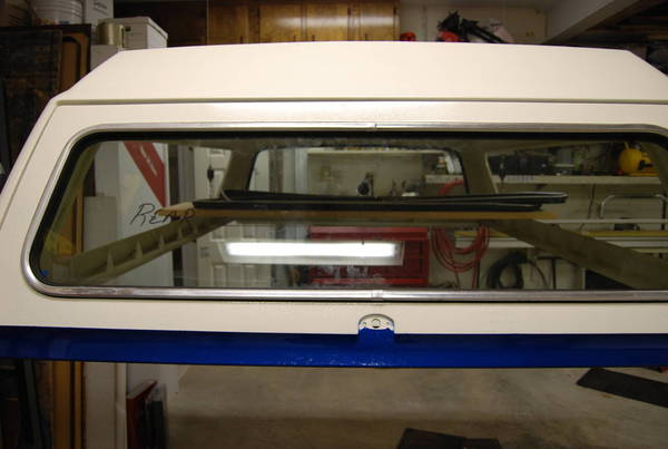

Put the glass and the back door on , and the front glass on.

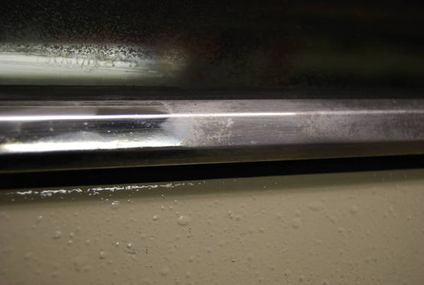

Played around with polishing the anodized aluminum trim around the rear glass
What did you use to start polishing and is it ok to polish without stripping the anodized coating? I bought some Mibro to polish a little around my grill but haven't used it yet. I'm a little nervous and don't want to ruin it. I only have a few scratches on it and it's an original piece stamped from the factory. I may just take it in to a shop to have it redone if I can build up enough trust to do it.
The little bit that I did right there was done with #2 polishing compound and a Cotton wheel on a pneumatic die grinder, at a low speed.
I'm not sure but I think it took off the anodizing.
Yeah, that's what I'm afraid of doing. The metal is so soft underneath, it would be a pain to try to maintain.

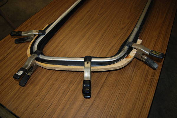

With reusing the old window seals , the corners were hard and the outside lip was folded under from age.
I cut out a piece of plywood the same shape as the window, heated up the rubber with a heat gun.
Then clamped the plywood under the lip to hold it up until it cooled.
It didn't take much heat to make it pliable , and it seamed to stay pliable after it cooled.
