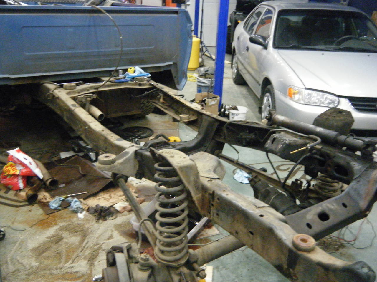

Bolts holding the cab on are the four main ones in the corners and then two more kinda above the front ones in the wheel wells right?
I think there is just the 4 that hold the cab on...you can see the 4 bushings in this pic:
Thanks for the picture! It wont be any trouble so I'll pop off the vin tag before the scrappers come pick it up in the morning. It took us all day to tear one down. We pulled the fenders and grill as one three sided unit. Pulled the cab and sat it in the floor, pushed the donor out in the parking lot and in the morning we do the same to my truck. Hope to have it bolted on and be able to drive it by sunday... That may be a stretch knowing the way things go for me though.
