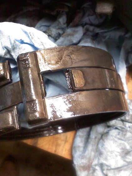

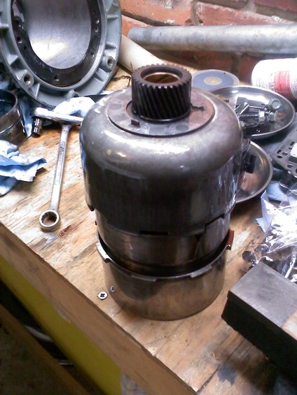

This is why I had to rebuild my C4 (everything else actually looked fine, but I had it open so I went ahead and did the rebuild):
Once I removed the front pump bolts, I literally got to this point in 3-4 minutes...I think the most important part is keeping everything in order:
^^^You make it sound so simple.
Yeah seriously. I've only helped take apart one transmission on a Windstar and that did not look simple at all. But Maybe these transmissions are a lot easier.
