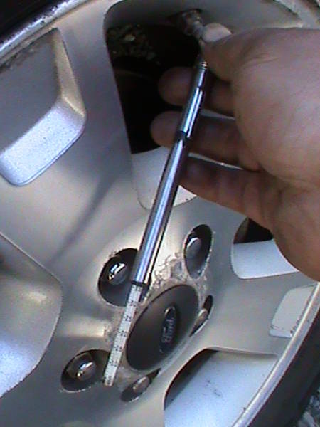

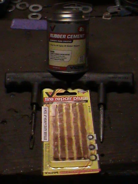

Well nothing worse than coming out to your vehicle to do some errands,only to find that dreaded flat tire....Dont sweat it,in this case by the time you have droped your spare and lossend your lug nuts..ill be back on the road...Ill show you how....First here is what you will need to do the job.Made by Victor.These T handled Tools are the best imo for plugging repairs...The T handle gives you very good leverage compared to the screw driver type tools.Most your common auto parts stores carry them...The initial cost is well less than what a tire repair at the shop will cost you....

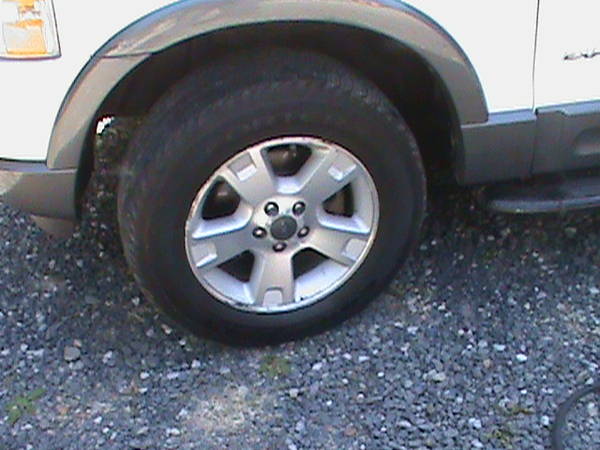

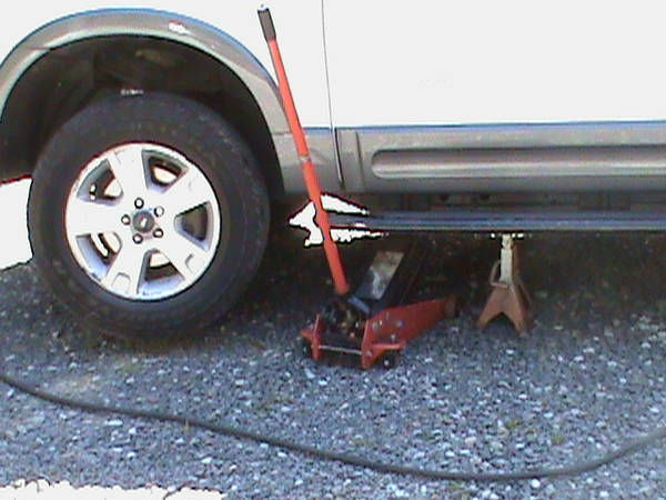

first raise the vehicle with a approved jack and place a jack stand under the frame for support,

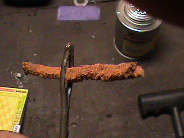

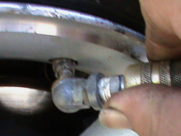

Next fill the tire with air...with a spray bottle of dish soap and water spray the tread and begin to slowly spin the tire,once you find the culprit remove it with a pair of side cutters...In my case what ever punctured the tire was blown out for i only found the slit....

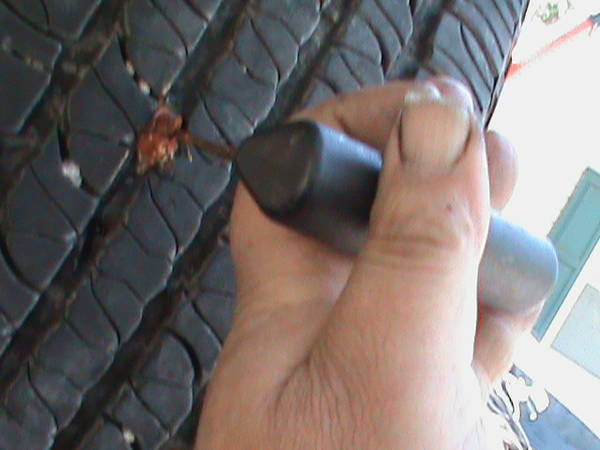

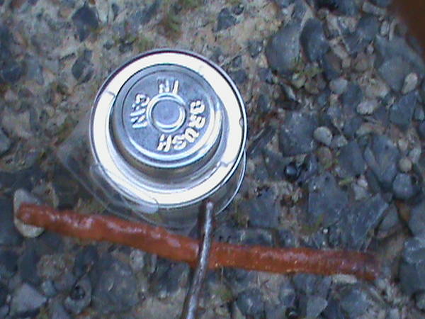

Next with air in the tire we must work quickly to complete the plugging process. air in the tire keeps plugging resistance to a bare minimum and makes the job a heck of alot easier...OK Take the tool shown below and coat it with rubber cement...
Then insert the tool into the hole with steady slow pressure all the way till the tool bottoms out at the handle...Leave it there for the time being...
Next take a plug and thread into the plugging tool....then coat the plug with rubber cement....

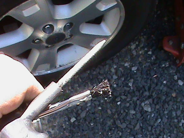

Now remove the tool from tire that we left in...Take the plugging tool and insert the plug into the hole... with a slow steady push insert the plug till there is about 1/16 of an inch of the plug visible...Stop! slowly begin to pull back on the tool...the plug will seat it self no need to worry about pulling it back out of the hole..

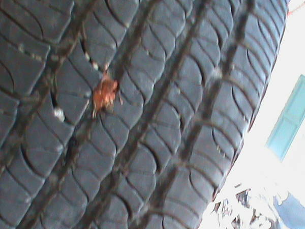

Your repair should look similar to the pic below

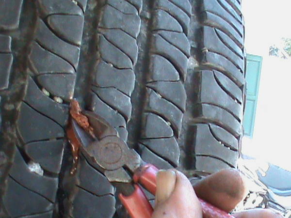

Now take those side cutter's and cutoff the excess plug down to the tread..cut only and dont pull on the plug....
Then air the tire to recommended pressure....check for leaks with the soap solution...if no leaks are present lower the vehcile,and your ready to roll!
Our repair is complete and we didnt have to remove the tire from the vehicle
